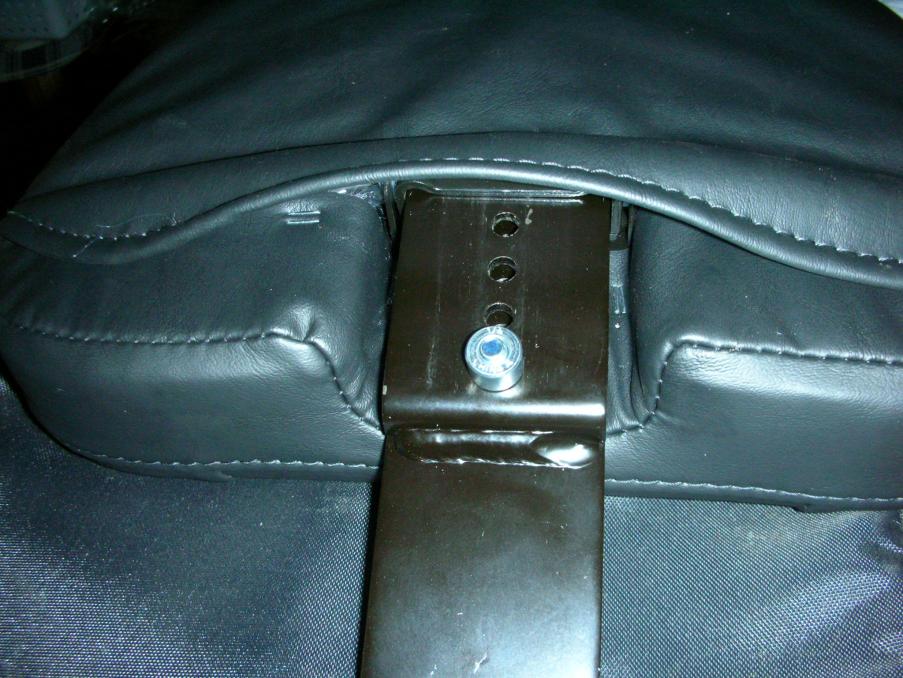

Default My Fix
Originally Posted by HDV-GLIDE
I'm at a lose for words............Please don't attempt a cam change LOL.....
In my defense, the OEM pin is not held in by much, and any lateral movement will break it loose as I found out. I had to either buy another backrest with a new bar/pin, use the broken one in the lowest position, or fix the old one.
HDV-Glide, tell me what you think now?? I drilled out the three holes in the bracket and inserted a 1/4" screw from the front through both holes and inserted a collar on the screw end which locks with a set screw. See picture. The backrest can now be moved up and down and sits on the collar much like it did with the pin. The only difference is that the OEM pin locked the backrest so it would not move up/down with the pin installed, and my collar just uses gravity to keep it resting on the collar. I also took picture of the OEM pin and what looks like a circlip but isn't, it is a piece of the pin that broke off. It was a press fit into the bracket.
So can I help you with your cam install now???
Attached Thumbnails Adjustable backrest removal-dscn2628.jpg   Adjustable backrest removal-dscn2629.jpg
