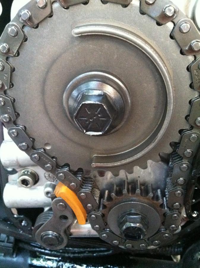

Default Pictures of my cam tensioners
Well got bored so pulled the inspection cover off, here are a couple of pictures of my front tensioner. Doesn't look like the hydraulic upgrade has been done but the front tensioner looks ok, need to get a mirror for the back one. Anyone have some insight. Should I just put her back together and start looking at possible wiring issue for the light???

That outer tensioner looks good. As said b4 get a real small mirror to look at the rear one. If it looks like the front ride it the rest of the season and do your cam change over the winter. Light sounds like a poss ground issue, pull off outer fairing and check wires. As for a cam choice if you do allot of 2up I'd go w/ andrews 26, put em in mine last winter w/hydraulic upgraded tensioners and am very happy.
My RK had 20k Miles, front tensioner looked good......inside tensioner was worn - 60/70%. Fixn to do the upgrade myself.
Get a small dental mirror from walgreens or cvs to look at the inside one.
Search on the forum......there is plenty of info/pics and even videos on the cam plate and cam upgrades.
atrain68 , a forum member, has some excellent info and pics on the cam upgrade/inspection, etc....
