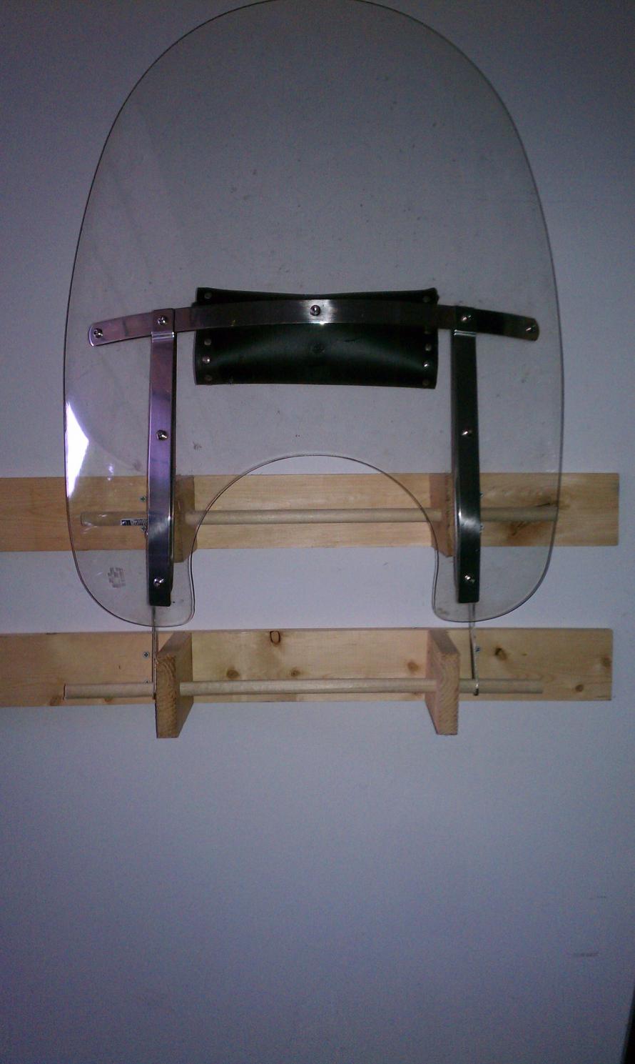

Made this rack today to store my windshield when it is off. There were some other posts with much more creative and better looking ones but search is down so I can’t find them add this. Mine has the advantage of being easy and cheap (scrap wood). Putting this up just in case someone is searching and this helps.
A few dimensions:
5/8 dowel
Top bracket - wall to center of hole 4 & 3/8
Bottom bracket –wall to center 5 & 5/8
These dimensions include the ¾ for the cross piece
Dowel to dowel (center) is 7 & ¾ but what I did was wall-mount the lower one and use the windshield to get the top one in the right place. The actual vertical would be something a little less than that. Gravity helps hold the windscreen on and the wire clip is making it secure.
Could use a little paint, I guess.
This leaves about a 4.5” gap at the top of my shield to the wall so I could have made shorter brackets and had it a little closer to the wall and probably would if I was doing it again.

Thanks for the post. I need one of these and this is a practical way to go about it.

good build! and a good way to protect your shield while it's off
