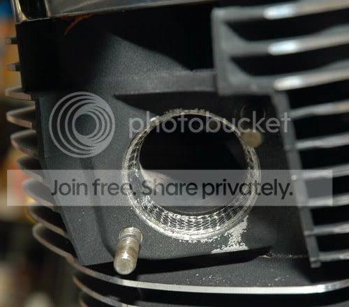

1. The exhaust "gaskets" are actually pressed metal fibers. When you take off the stock exhaust, the gaskets usually are so covered in black exhaust "soot" that you can't see them. Take a pair of needle nose pliers and press them agains the very edge of the hole. If the gasket is in there (which it should be) the end of the hole will bend and you'll be able to grab the gasket with the pliers and pop out the used gasket. Here's a pic of what the gasket looks like in the jug before it gets black with exhaust "soot". Take your pliers and press in against the very edge and it will bend making it easier to grab and pop out.....
2. When installing the new gasket, yes, it will be fairly tight but it will seat in the hole far enough that it will be flush with the jug outer wall. Make sure you install the gasket with the tapered end towards the outside of the jug.
3. Once the above steps are completed, install the new header. It will be tight and you might only have one or two exposed threads on the mounting posts after it passes through the flange, but once you get the nuts started, they will pull the flange, thus pulling the pipe, into the soft metal gasket.
