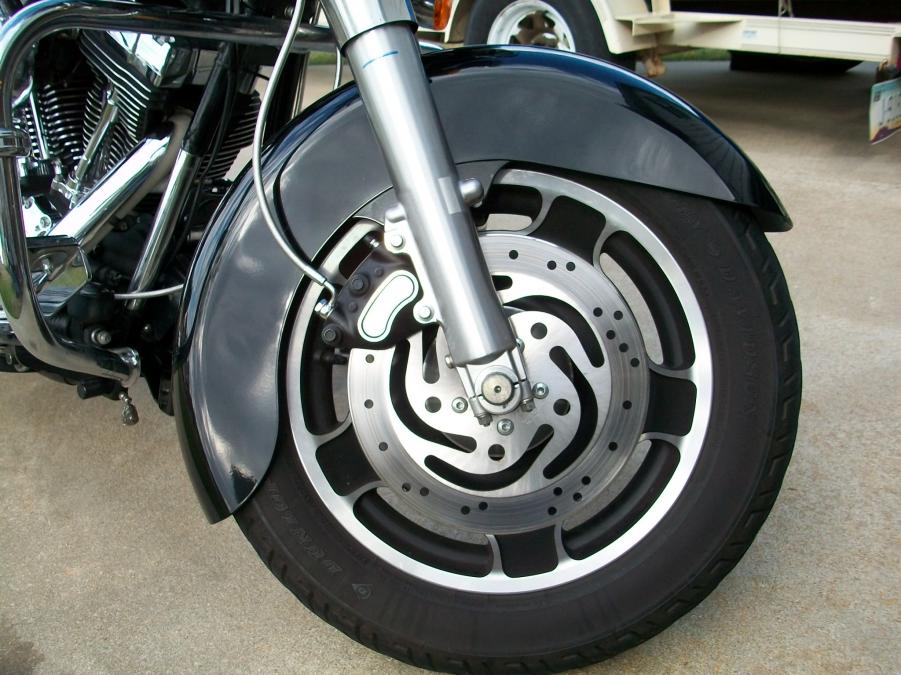

I mocked up the front fender this morning. Not bad for $100. Heading to Lowes to run get some spacers. I think it looks pretty good, not as good as some of the money bag bikes on the forum though.
Looking for opinions on height off the tire. Do you folks think it should be a tad higher off the tire?
thanks, Jim
Old May 13, 2012 | 08:38 AM
z71_fourwheelin's Avatar
z71_fourwheelin
Joined: Mar 2008
Posts: 732
From: SE Alabama
I would keep it from 1/2" to 1" off the tire. The more space the less chance of something in tire grabbing and ruining your fender.
That's a good call.
I was thinking the less space would prevent something from getting between the tire and the fender.
