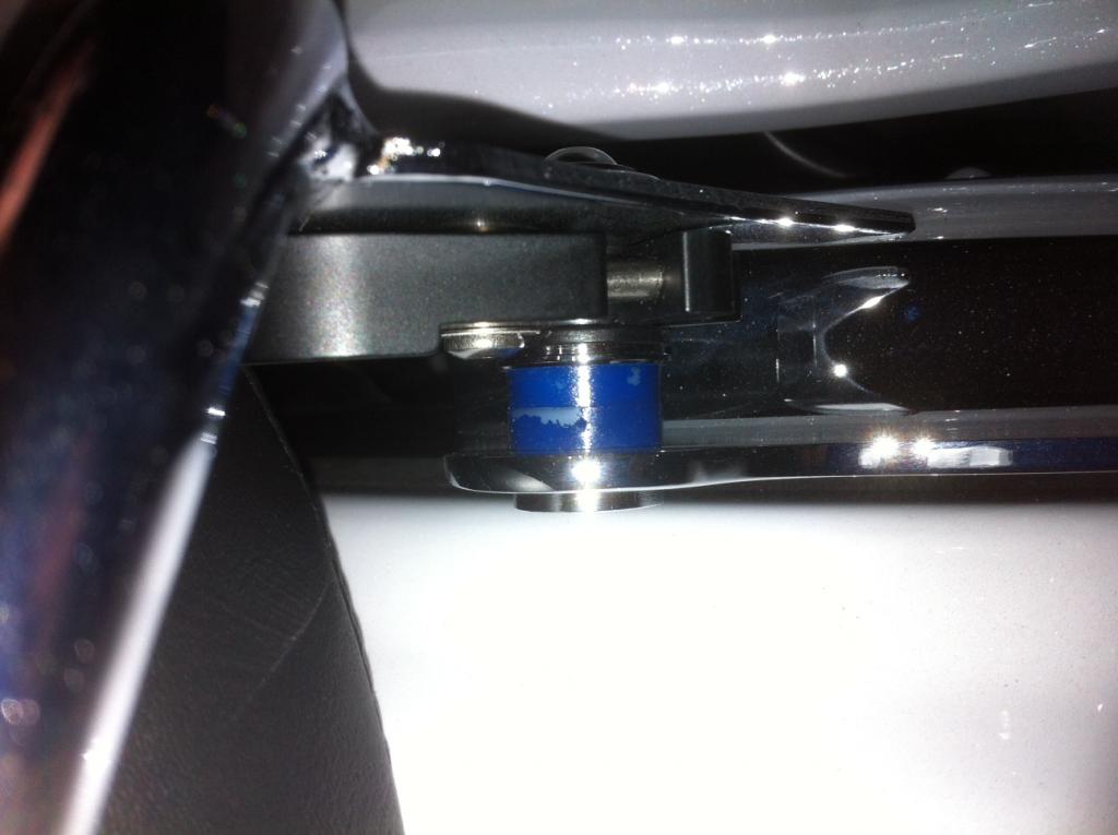

replace the 2 metal sleeves on the forward dock point with 4 nylon bushing spacers (two on each side) from lowes or home depot. works perfect over 2800 miles using them and not shake rattle and roll. all fits to perfection. forgot the size but you can bring the metal spacer and place two nylon bushings togethor to size up but go about an 1/8 inch smaller.
Not sure if this would work for my issue because my tour pack mounts on the front metal sleeves. It's the back that I am having the mounting issues with.
