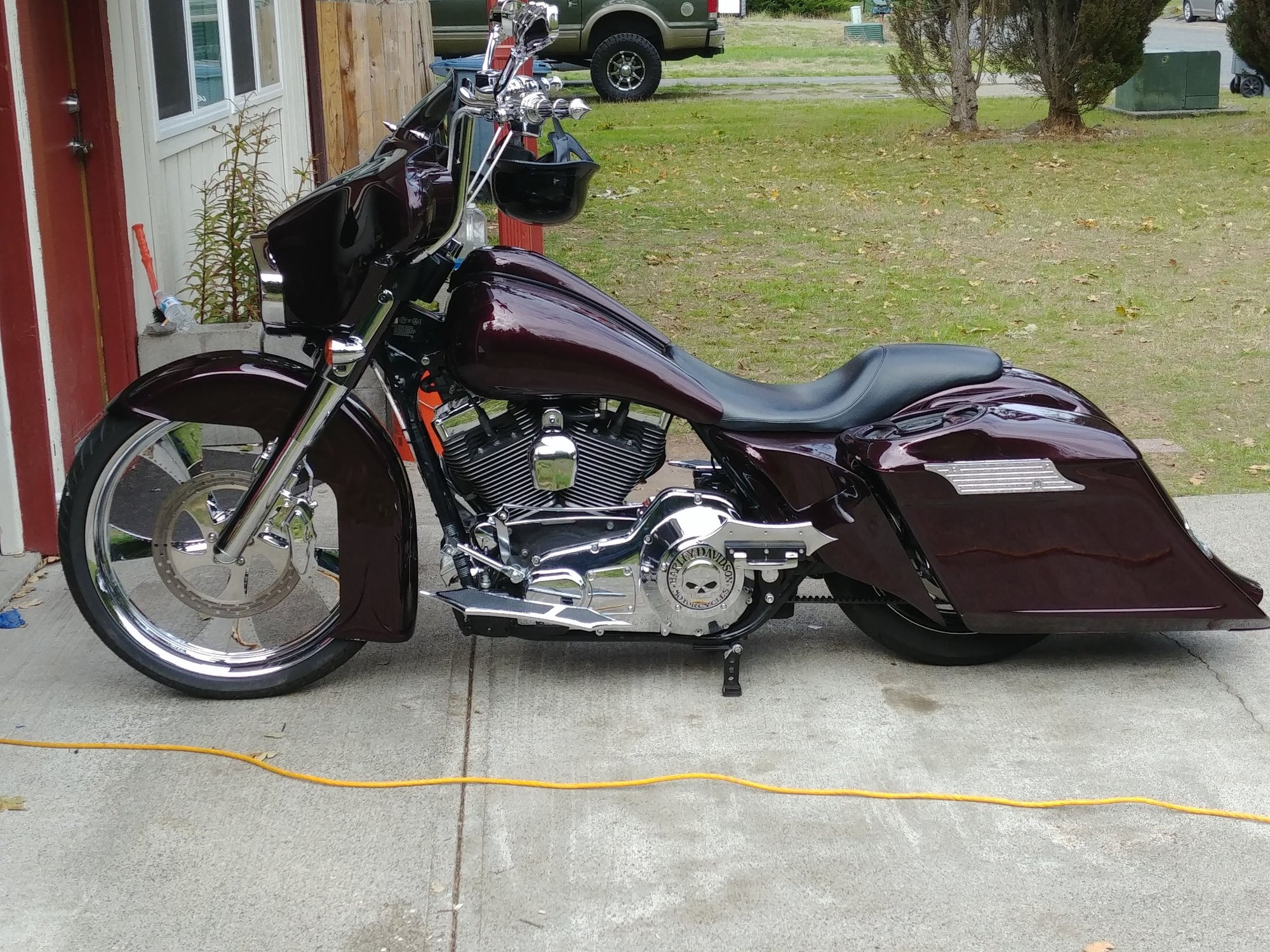

Riding season? Really? I live in Washington as long as there is not ice on the road I ride. If its raining I might not want to ride my Harley with my leg over the filter, sure.. That's why I bought some rockets too! I ride them when it's raining or my Harley(s) are broken. Sometimes just because I want to. Point is with the following never stop riding.
1. Thick hoodie
2. good riding jacket
3. vest
4. MASK
5. INSULATED GLOVES, not heated.
6. Alpinestar Leather pants
optional: long johns
7. bring dry gloves , sweatshirt and jacket for long trip home,
Riding season... Ain't y'all got big a$$ bugs in the summer? hell I guess I don't know, but that might be end of my season! Ride safe keep it up and watch out for big a$$ bugs that s*** might take a rider down! Hope not.
pics
