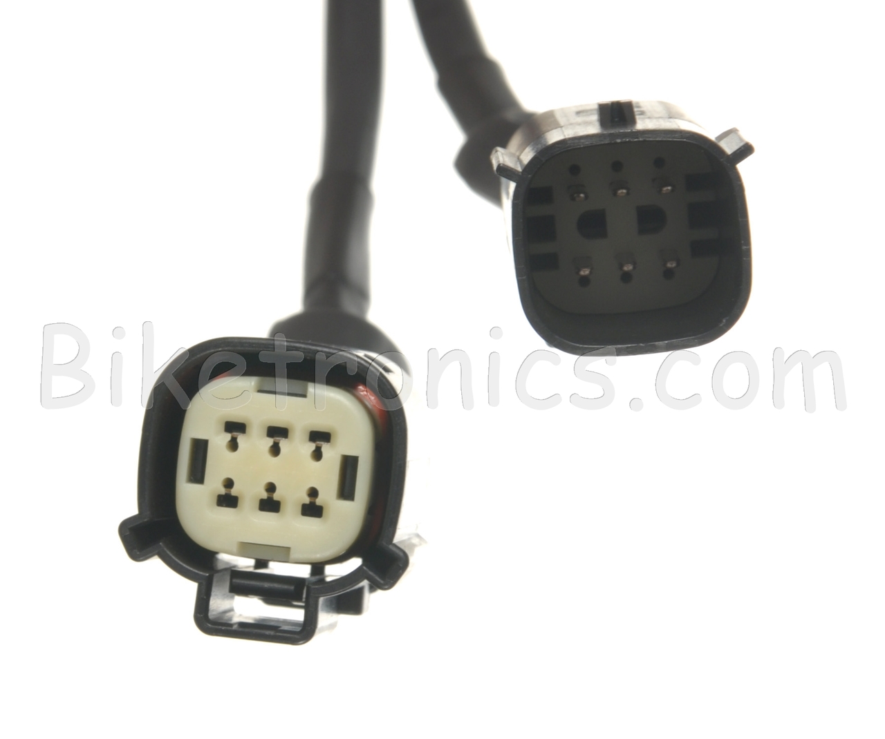

Folks - I have a 2013 FLTRU - I ordered the 801M from Biketronics, its the one with connectors that look like this: http://www.biketronics.com/product_i...ges/9_zoom.jpg
Supposed to be for '10-up touring.
Anyone else have it? I feel like an idiot, but I'm dont know where it connects.
Biketronics is puzzled because I have the HD Run/Turn/Brake module, and they are surprised that it has the 8-pin rectangular connectors, and in theory the BT load equalizer should plug in there.

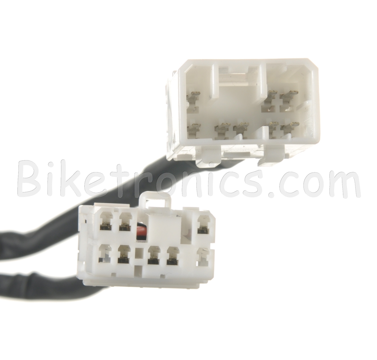

They are sending me the version of the 801 that has connectors that look like this: http://www.biketronics.com/product_i...ges/7_zoom.jpg
Which looks like the connectors for my R/T/B module.
If anyone has a 2010-up Touring bike with a Biketronics load Equalizer *and* the HD R/T/B module, I'd be interested to hear what your setup looks like...

I went with all Custom Dynamics on my 2012 Limited. Says right on their web site for the HD stuff (for 1999 to present) that it is 8 pin connectors. Everything I got from them worked great the first time!
On the Custom Dynamics web site it says the 6 Pin Street Magic Signal Stabilizer only Fits Harley Davidson 2010-13 Street Glide/Road Glide Custom
(Does not Fit CVO Models)
The 8 pin connectors are Plug and Play on '96-'10 Softails, '97-'11 Dynas, '97-'13 Touring (except Street Glide & Road Glide Custom), and '99-'03 Sportsters, '10-'13 HD Trikes; '11-'13 Road Glide Ultra
Hope that helps!!

The BT801M is meant for Street Glides and Road Glide Customs only. They use a different connector. For your FLTRU you need the regular BT801 which has the rectangular white plug. If you take your seat off and look at the rear fender there is a plug on the right side. That is your turn signal harness. Refer to your other thread that I made several replies to for how to run them in sequence.

Well, I think he assumed, like I did that all 10-later touring needs the 801m, but you can see why I'm easily confused (see below), the 801M says, as you state, for 10-up FLTRX and FLHX which is very specific, I just figured that all 10-up touring is the same. There's another part (801) thats for 01-up "Soft/FL/Dyna 01 and newer" which I assumed wasnt for my bike, but of course the "FL" part says it all. <sigh>
