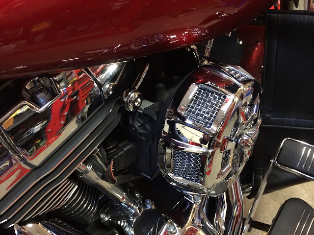

You need to be able to vent either to the atmosphere or right into the throttle body. This is what I did and it's been working fine now for over 3k miles:

Hi all,
Thought I'd throw my 2 cents in. Fresh SE 95", 510 S&S gear drive, stock model 06 take off heads, new se cam plate and big pump with the good umbrellas. Had AN Big sucker but I changed it out to SE ac. It started puking some at about 2000 miles, not bad but I would just wipe ac when I would check oil. I told my builder (Yellowstone Harley) and he said just run a fuel line down to ground. There is only one nipple off rear breather and I ran 3/8" id down over starter and zip tied it a couple inches below swingarm. I bought a couple rubber plugs one to seal back plate, the other went right over rear shifter shaft with just a little trim. I don't get any on swingarm and I guess my point is when it chilly out (Montana) you get quite a bit on condensation w/ the oil splooge. I really don't want to burn that in my engine. I look at it as a dust reduction project. Its dirty way up here :-) I would notice it on my carport floor when it would all condensate out overnite. I know it doesn't look fabulous but function over looks for me.

From: Albany, OR
I took an old Stage I backplate and cut off the breather ears, filled the holes with epoxy and painted it black. Bought a Kuryakyn Bluegrass breather kit. Ran the hoses up under the tank and backbone, venting by the steering neck. After that length of hose the only thing coming out was condensation, not even the least bit oily either. So I just stuffed some cheesecloth in the hoses to keep the condensation controlled yet still let it breathe.
am i missing something here? the only think holding your breather assembly on is the throttle body itself? I would think that not a wise idea considering the weight now applied to the TB 3 bolts now. Those A/C kits and covers aren't light by any means....
