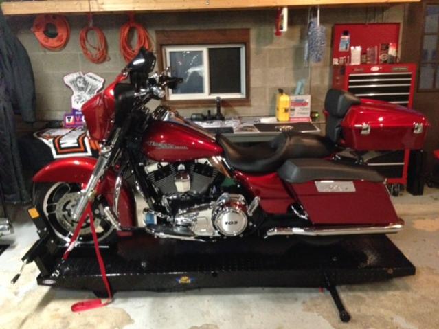

Default Wide shot
Big red on the lift....
crimeguy7, what touring pack and front visor/shield do you have on your bike?
Looks great!
