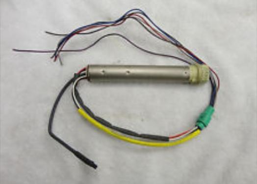

Thanks for all the replies. I hope they will be here by Friday. Havent started until they get here. What is the green wire on the TBW for?

It's not a green wire, its a green plug and it was put there to make you cuss and stomp and throw ****. The green plug is very fragile and WILL cause you problems. Some use the Screamin Eagle version as it doesn't have the green plug. Some, like me, cut the green plug out and solder back together the corresponding wires and cover solder joints with heat shrink. If you need to lengthen the harness you can solder in your extensions when you cut out the green plug. I also extended my hand control harnesses this way too. Not sure if the SE TBW harness is long enough to do 16's. It may need extending as well. There's also aftermarket wiring extension kits that are plug n play as well.
Attachment 348223
I can see how that would make it a pain in the a**. Thanks for heads up. I'm just doing 10"s so should have plenty wire.
