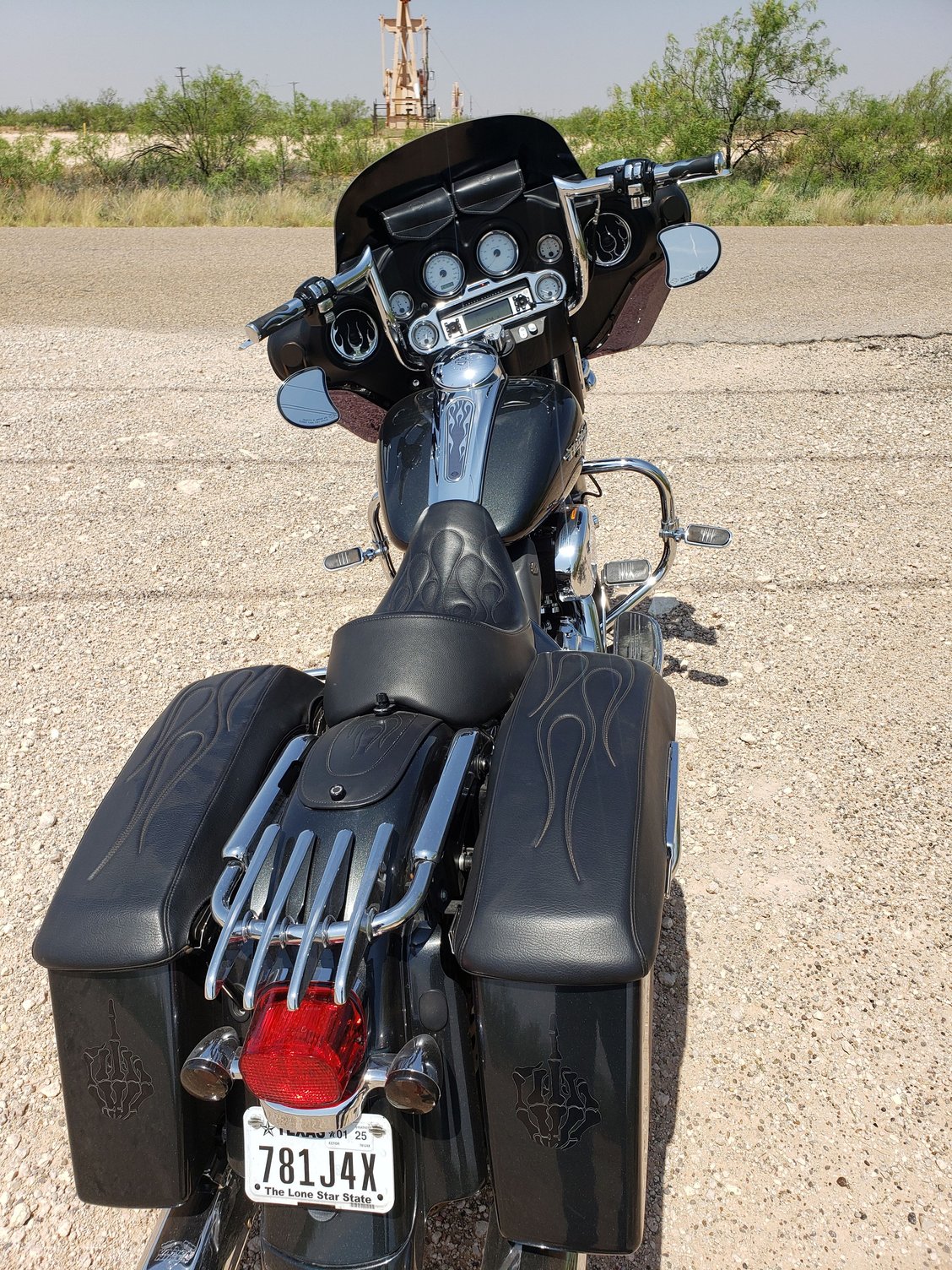

I've been running a 180 Dunlop tire on my stock 08 streetglide for 15 years now with no issues its really close to the belt but will not rub.
