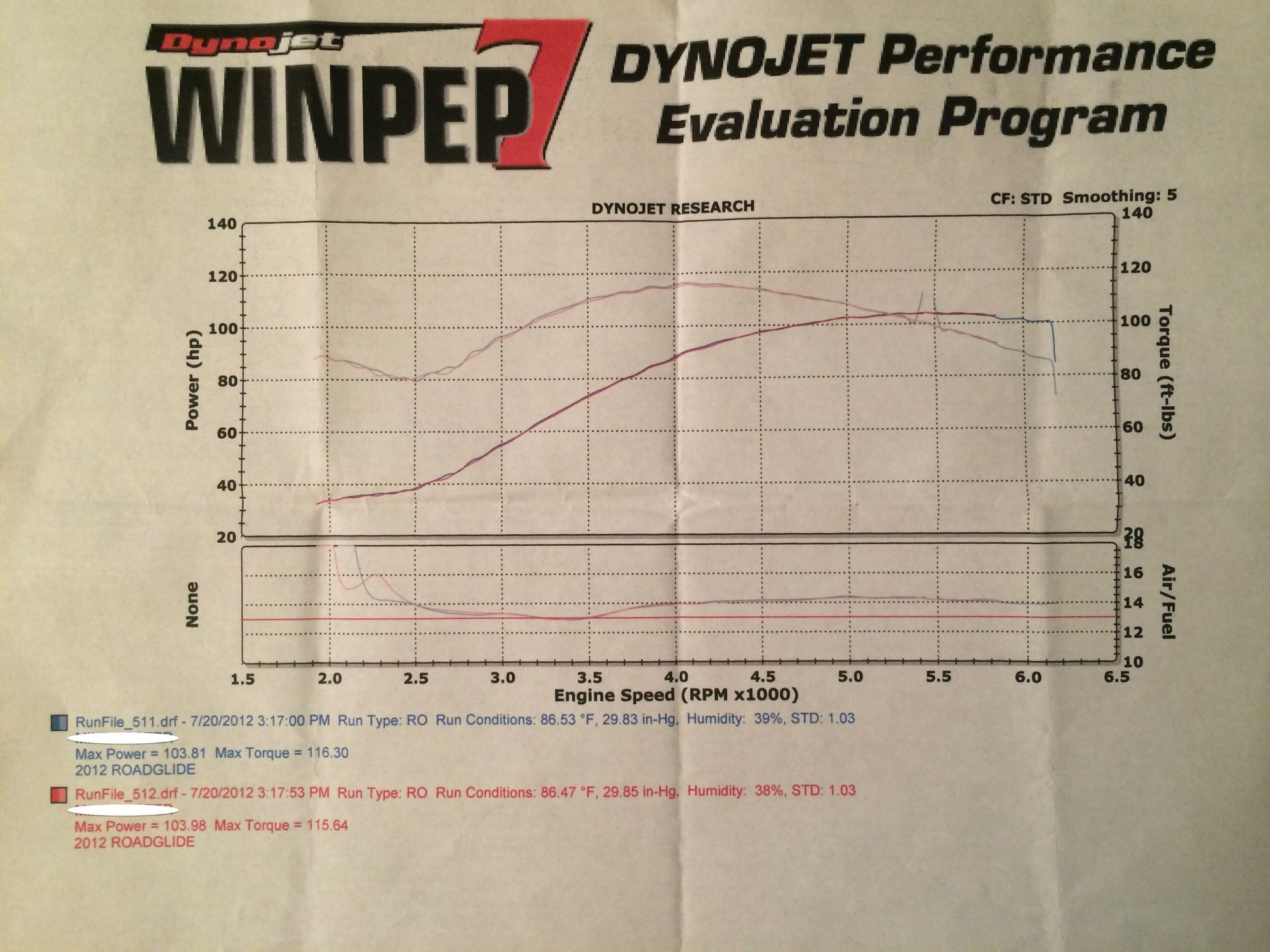

Originally Posted by ultraclassic53
What kind of tuner are you using and do you have a dyno sheet by chance ?
Tuner= Power Commander
Looks like: (approx)
104 HP
116 TQ
Seat-of-pant = 100% awesome
Wish I knew what stock was.. Anyone know?
I did this with only a few hundred miles on the bike, so I never really knew what stock felt like when pushing it.
If I did it over, I would document stock performance better ahead of time.

Originally Posted by 2807
Looks like:
104 HP
116 TQ
Whats the SAE sheet look Like ?
