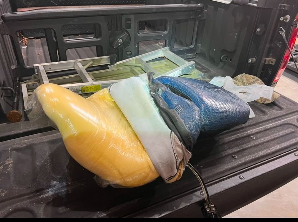

Re: Original Harley Road Zeppelin seat.(air bladder)
The manufacturer no longer repairs their product.
The phone number that was listed for inquiries is no longer answered, and they won’t respond to emails.
Harley won’t repair them.
No upholstery shop that I have called (+10 in an 3 state area), will work on them.
No spare parts are available to effect repairs.
Be prepared to fix them yourself.

What “broke” on mine, was the air hoses from the valves to the bags apparently deteriorated and crumbled from the engine heat.
Pulling the seat cover back, and replacing the lines with small engine fuel line restored their function.
I still have a slow internal leak at the valve body, so the compressor never cuts all the way off. (power comes from the accessory switch so I can shut it off)
But again, there are ZERO spare parts available, and MILSCO (the manufacturer) refuses to respond to any communication efforts.
