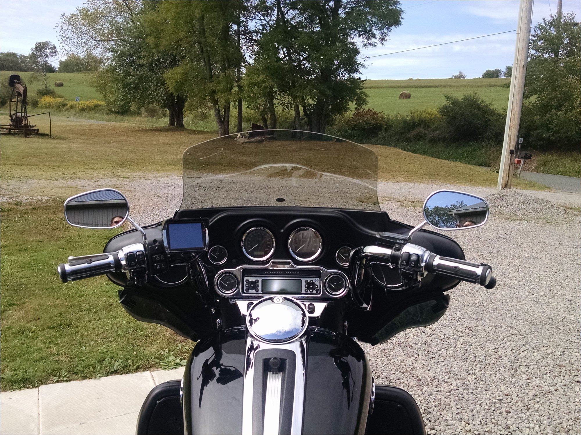

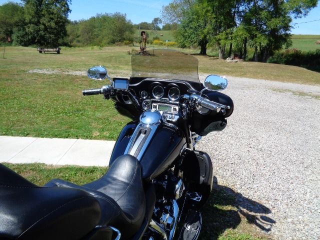

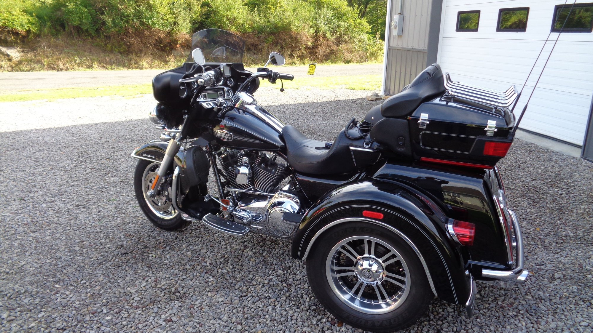

Default Casper should know
Just going out for the first time
grips are a good deal higher and closer but straighter
All cleaned up for the Bike show in Clarion Fall Festival of Leaves
I have no knowledgeof 14' and newer my 09" has a cable clutch there is a difference with hydraulic clutch all I needed was a +6 cable for clutch. Wide sweepers I believe are 3.3 inches wider and grip angle is a bit straighter, good luck on your choice a very persona one. ride safely fearless
