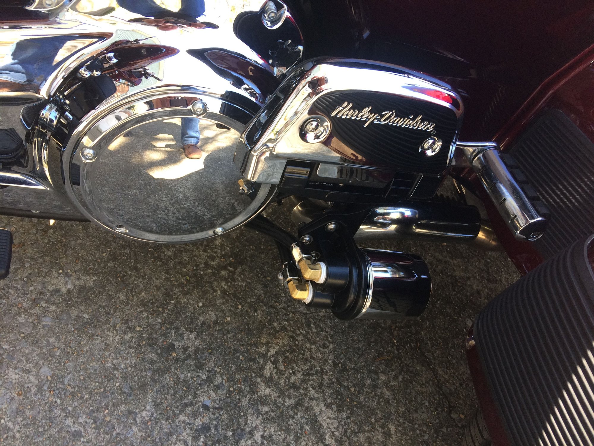

Default J&S Jack With DK Custom Products Oil Filter Relo on 2017
Here are a couple of pictures of using the J&S Jack with the DK Custom Products oil filter relocation kit. The difference between my jack and "s060's" jack is that his is air and mine in mechanical. The mechanical jack was almost a problem with this combination, but for the first time in 68 years, it appears I got lucky. The first picture shows the oil filter attached to a bracket and while it appears low on the 2017, the filter is above the bend in the frame, as described by "so60". The problem I had (have) is that the forward part of the foot pump lever would come into contact with the filter if the foot pedal were pressed all the way down (picture 2 below). I am limited to about one-half inch strokes until I get some height on the bike. It works (picture 3), but bottom line is you have to be careful with the manual J&S Jack when you have the DK Custom Products oil filter relocation kit installed on a 2017.

Default Trike Lift
Good pictures John. One thing I will add to this, the "riser" on the rear arm is naturally what you have to watch out for while setting up to lift the Trike. I slide it under the Trike to where the riser is just maybe a half inch to 1 inch past the drive belt. At this point the jack is back pretty close to the rear wheel. I then go to the other side and see where it looks like the riser is going to hit. I just make sure the side of the riser is at least a 1/4 inch behind the nut holding the crossover pipe mount (on my 2016) and appears to be lined up straight. I then start easing the jack up and keep an eye on the riser alignment and the crossover mount nut and mount. I bought the air model and I am glad I did. Arthritis in knees makes it tough without it.
