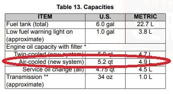

What my 2024 RG3 owners manual says.

The circled capacity is for a "new" system, ie a dry brand new bike from the factory that's never had oil in it. The correct fill is as ASA1199 stated. 4q initially then follow your check procedure to bring it to mid stick.
