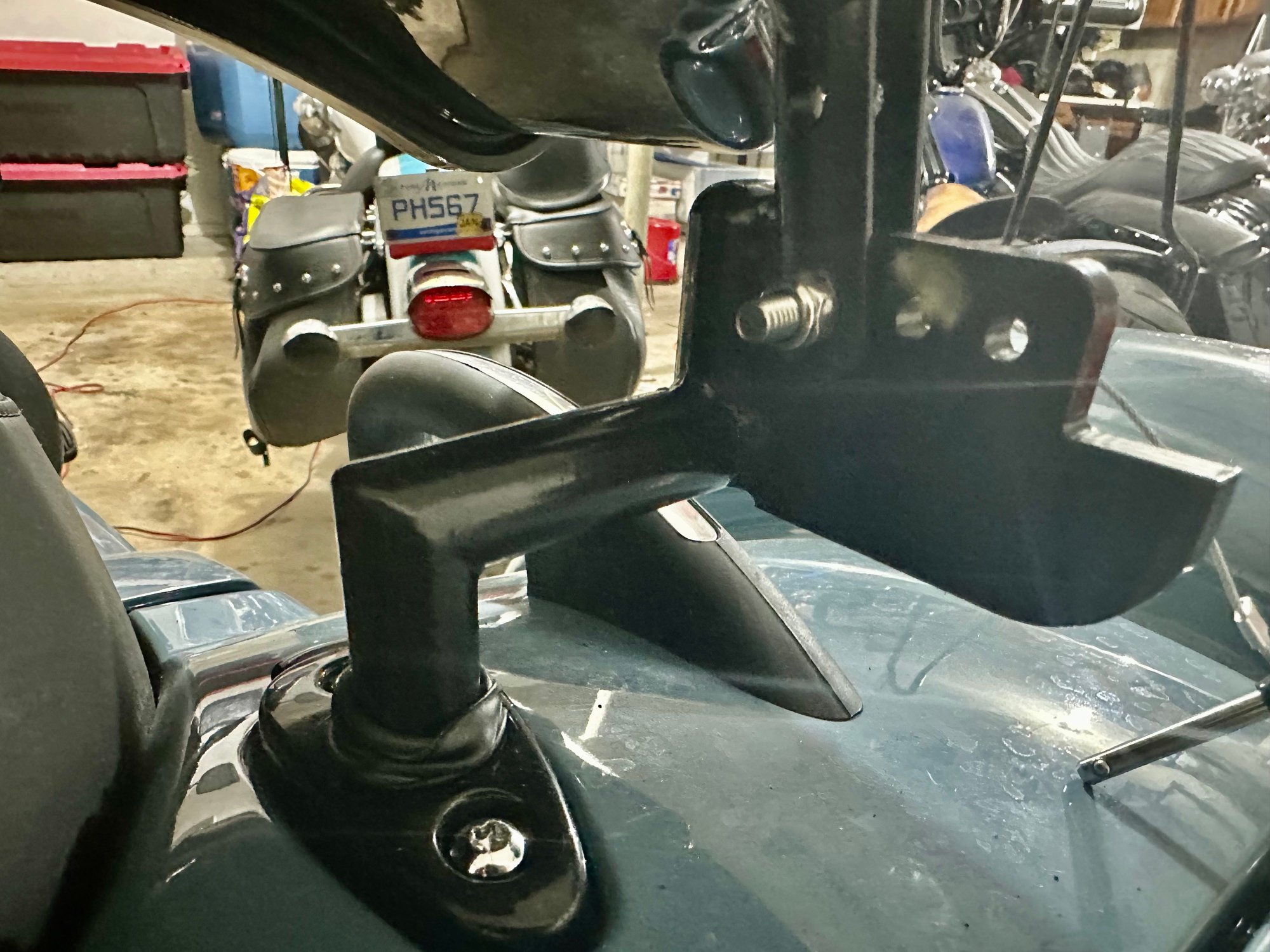

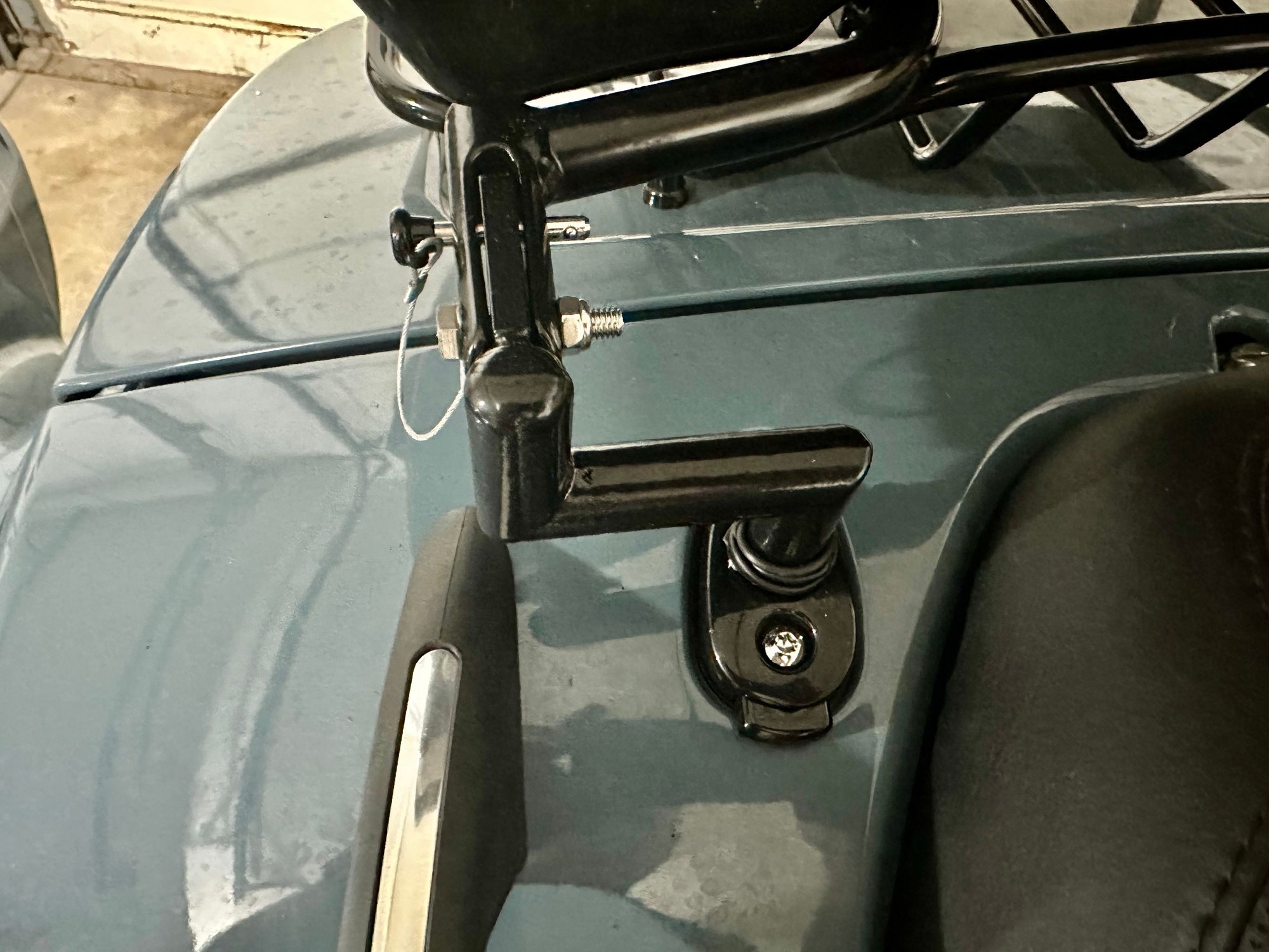

Just my opinion but I wouldn't have a luggage rack on the
FW lid if I was going to use the Tech mount. I just think it looks too crowded.

I suspect the OP had the luggage rack before he bought the GQTech mount. And once you have the holes in the trunk lid, you can't undo them.

You can buy flat black plugs for those mounting holes. And under the tech pack you wouldn't see them much. As I said just my opinion.

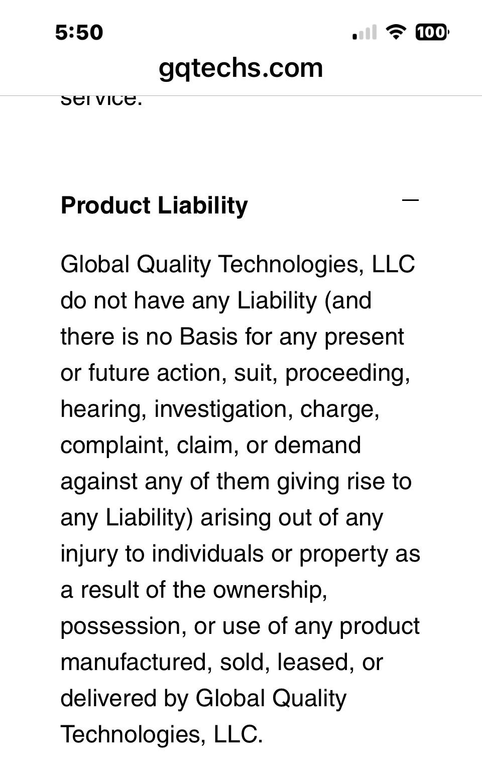

From their website:

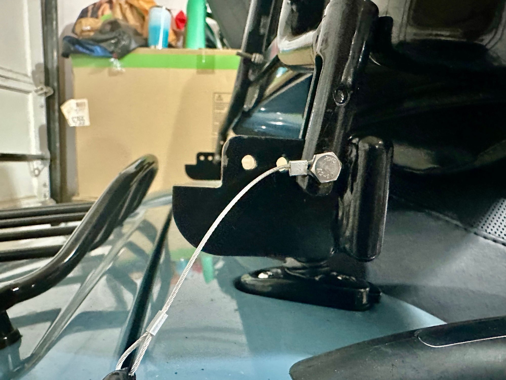

There is a plate that you install to reinforce the mounting location. It allows the mounting points to offload stress along the frame vs the backrest mounts within the outer fascia. To be fair, this will likely hold very minimal of things. Mostly stuff my wife needs ready access to. There won’t be any passengers. The overall brackets appear sturdy and well designed. I probably wouldn’t put much in there, but it gives her a little flexibility. Sharing a few extra pics to get some further design context.

They had a booth setup @ Black hill HD during Sturgis and displayed this unit mounted on a Freewheeler. It seemed more substantial than I had thought just looking at the pictures. If I needed to mount a Tour pak on the rear of one of these trikes I'd give it a try. They were a hundred dollars cheaper at the rally also.

they make and sell the extra mount to make it more secure
