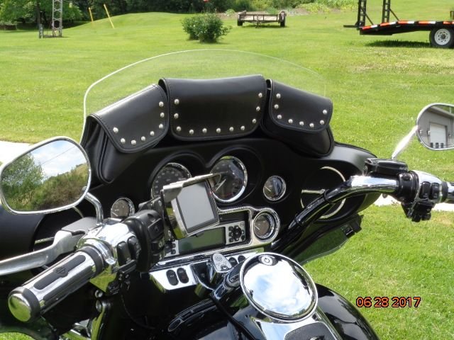

e
Love Jugs Fans lowered temps 20 degrees
wrapped exhaust DEI
Changed air intake Boyesen X force
Air deflectors and raised fuel tank to force air on motor rather than up in face.
added power vision tuner to maximize available power and best fuel air mix to run cooler longer
Love Jugs fans ECM tuner Air intake lose the Cat. in exhaust Lift the fuel tank 1.5 to 2 inches air deflectors remove left side mid frame air shield (give warm air some where to go spacers riders foot boards a starting list of my changes. Everything I have done is to run longer and cooler I have dropped my Eng. temps over 35 degrees on average now we have no real problems with heat. Fred
