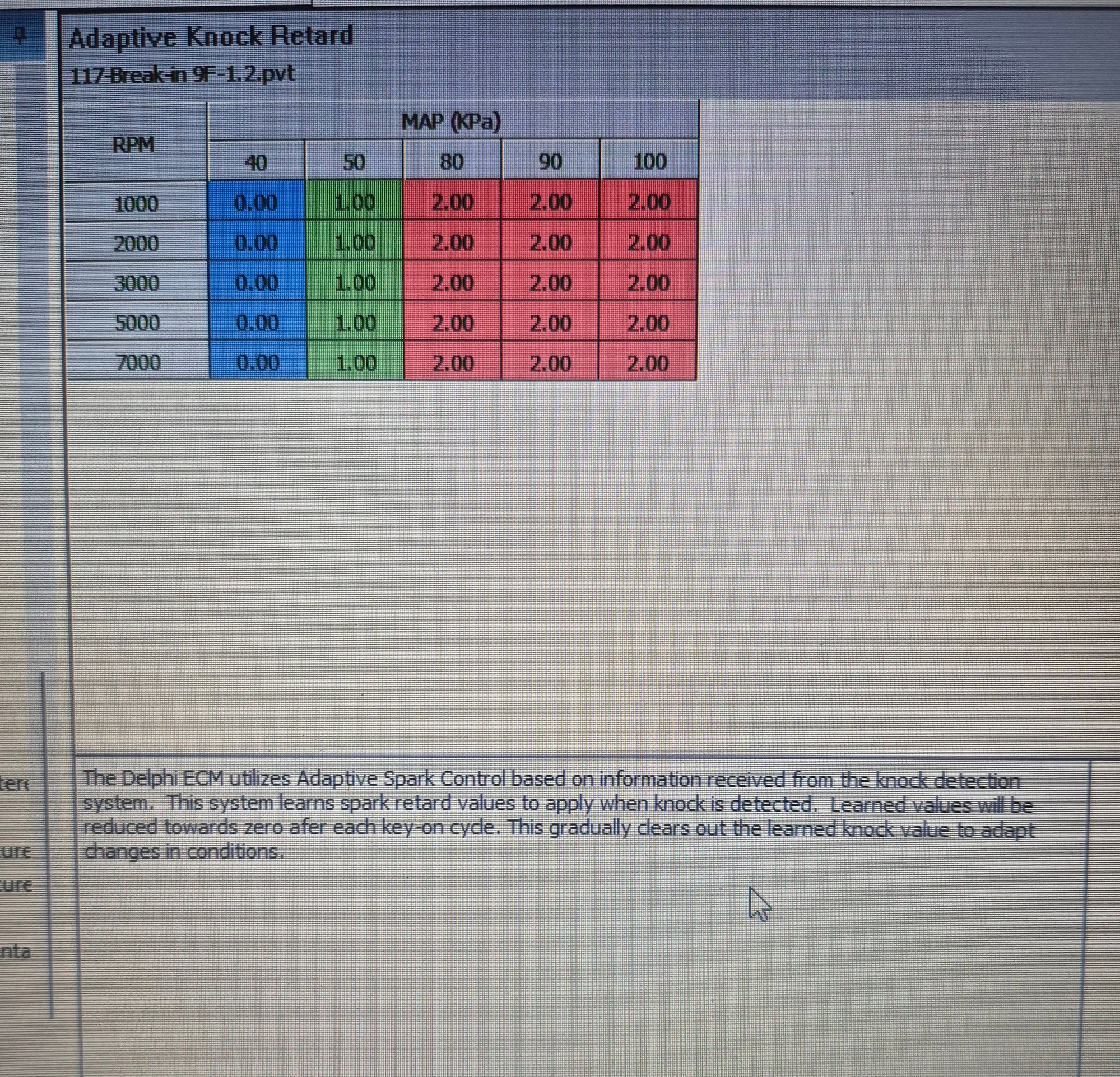

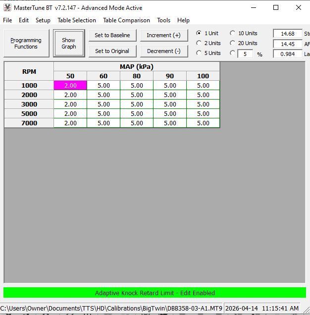

You should have a table that sets your adaptive knock retard limit, something like this. You just zero it out

I do have an Adaptive knock retard table but it also says that "learned values will be reduced towards zero after each key on cycle. This gradually clears out to learned knock value to adapt changes in conditions".
maybe I'm missing something here but are you saying that I should set this table to 0.00 across the board?
here's what I have mine set at..

Yes, zero while tuning. Two tables that don't get zeroed out are your AE and DE which lots of people do. Learned values will be reduced towards zero, as long as it hasn't pinged. I believe it's 50 key cycles to clear.
