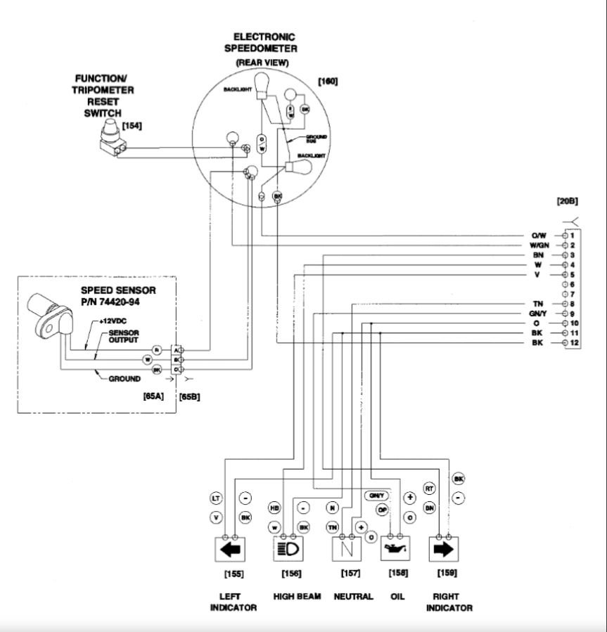

I have installed a new speedometer in my 1997 Fat Boy and followed the instructions. The instructions do not mention the red and black wires that went from the old speedo and terminate somewhere in the frame between the two fat bob tanks. Does anyone know what function these two wires are for?

https://serviceinfo.harley-davidson....b5665067a!!1!5
