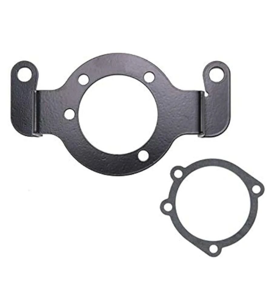

Hi guys iv got a 96 lowrider , the problem im having is the complete air cleaner system with carb attached is working its way off the intake , it looks like the carb and air cleaner are held on to the intake with nothing more than the rubber mount , iv looked on line and cant find anything for this model that would indicate any thing different , ,any help would be appreciated cheers

You should have a mount on the back of the air cleaner that mounts to the heads similar to this.

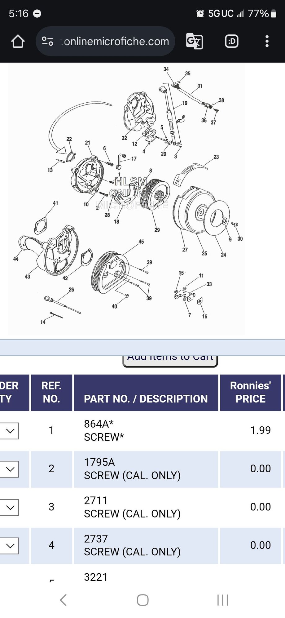

Welcome to the HDFORUM. This is welcome only, so briefly. Sounds like someone has modified your breather.
Post your question as a new thread here along with a picture. Title it like 'Need help with my 1996 Dyna Low Rider'
https://www.hdforums.com/forum/dyna-glide-models-9/
What it original looked like.
https://partsfinder.onlinemicrofiche...davidsonmc/234
