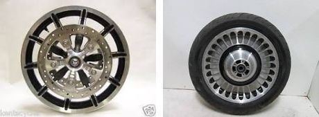

If the new-to-you 2014 "Impeller" front wheel didn't come with rotors then yes, you'll need new rotors as the "Knuckles" rotors have a different bolt pattern. But both are 11.8 Diameter.
Impeller vs Knuckles

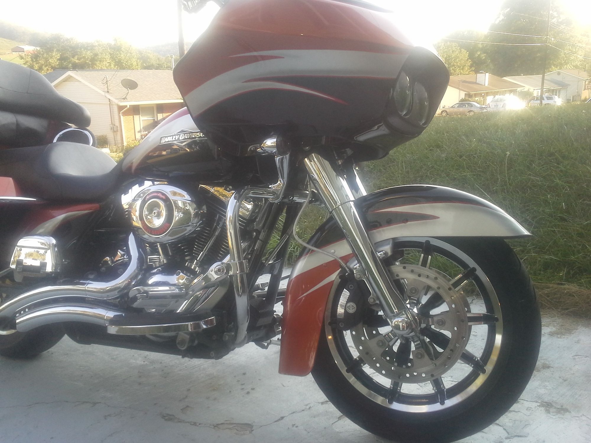

Photo of gizmo42261's Bike after wheel swap...looking good

Thanks.nothing special but stoked anyway. Not a fan of the knuckles. I guess I have some new garage art.
