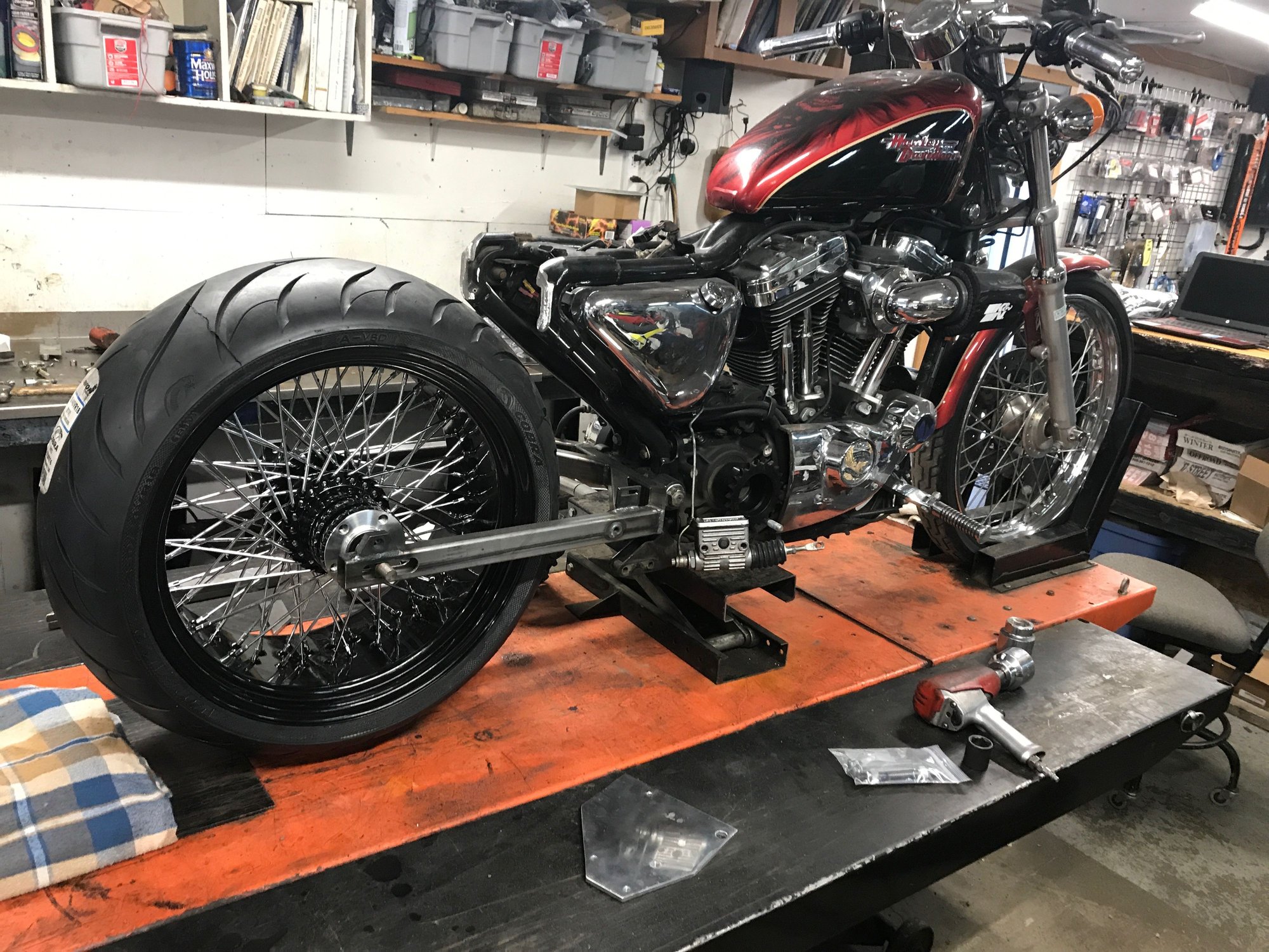

I’m actually having this done right now I have hhi mid glide on my sportster I got a DNA 80 spoke 21x3.5 with a narrow glide hub, plan to use spacers for wheel and caliper. For the tire I’m running a Avon 120-70-21.
For the fender I’m not sure yet I have to wait till my fork lowers are back from powder coat, but I plan to run one some how. I also have a 250 40 18 on the back
