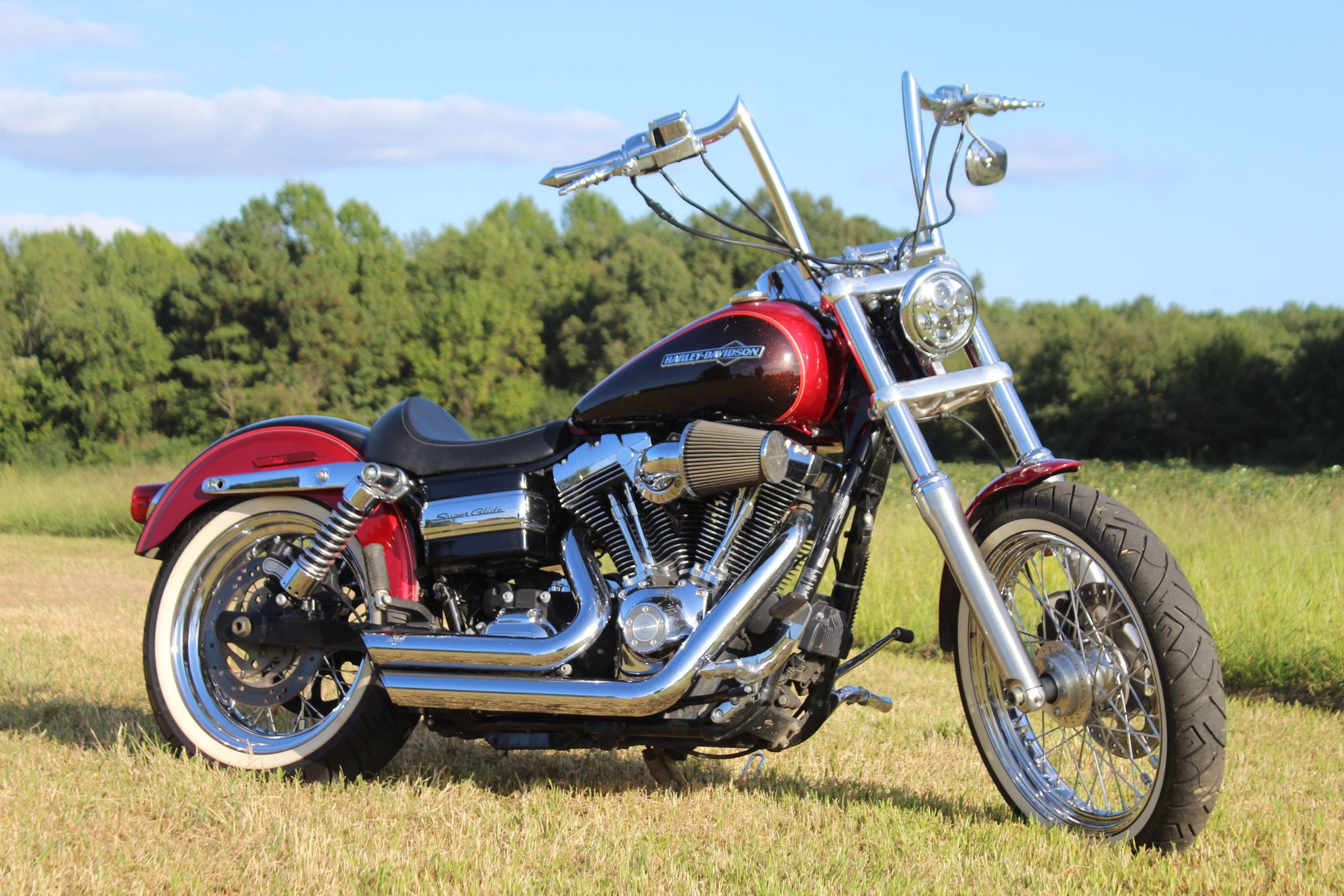

thanks guys. I am pretty sure I do not have abs also I have found that dna makes the fat spoke wheels specifically for my bike now but I don’t want to have to change my rear rim as well. Although it would look great. I use to run a fab shop before going into law enforcement so I’m familiar with the “diy” parts lol I just have no idea on the tolerances or sizes that will be needed.
And this is my bike and setup now. I just want to do a tank riser and a 21” front wheel

Originally Posted by 13fxdcHD
... I just have no idea on the tolerances or sizes that will be needed ...
Well, I do
Correct ... No ABS
I would look for a Original Equipment 21" on Craigslist or eBay. The 21" OE Narrowglide Hub is Asymmetrical, so slightly different than the Aftermarket NGlide wheels offered. The OE wheel can be adapted by the custom wheel spacers and caliper spacers
If you find a Aftermarket NGlide wheel that you like and matches (ie. another chrome 40-spoke wheel), you probably would want to use a Rotor Spacer instead of caliper spacers otherwise the caliper might rub the spokes
If you find any, you can post the link for confirmation and advice if desired ... I can probably work you up a Spacer Kit if needed
