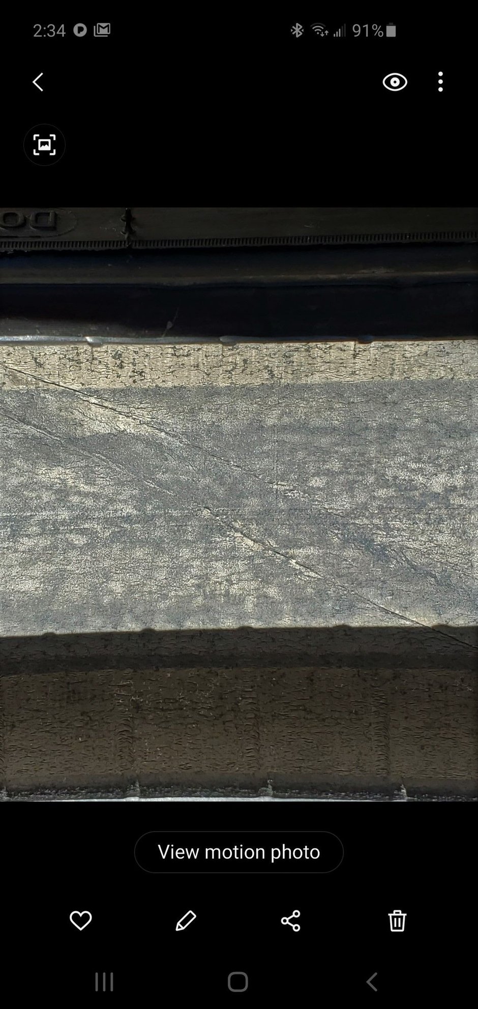

Hi all,
Here is a pic of the inside of my former C3 front tire. 2500 miles and lots of vibrations .....goldie
