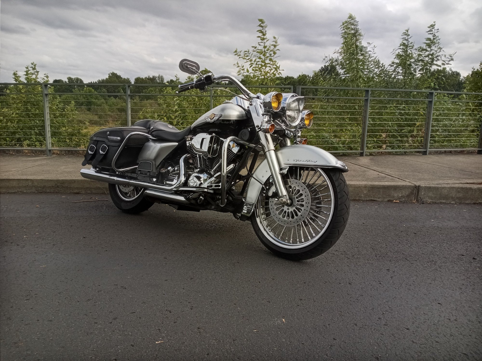

Let me save you a big HEADACHE. I just purchased this wheel for my 03 Road King. I emailed company several times to verify dimensions before I ordered. Turns out It's 3/4 inch narrower at the disc flanges. And same for the bearing outside to outside dimension. So I figured not THAT big of a deal - I'll just make/
buy 3/8 inch spacers for the axle and discs. So far just a little headache....Then I realized I need longer disc bolts and as far as I can tell, nobody makes them. Ahhhhhhhhhh
(BIG HEADACHE)

Ok so as the man said, they a bitch to get to wrk but I got them on a 05 EG. You got to have spacers fadded up, get new rotor bolts, (etc.) But they wrk!
05 HD EGhad to do a lot to make them wrk, but I got it done! And now I got a chrome set for someone with a 2016 RG that I got to do nxt.
