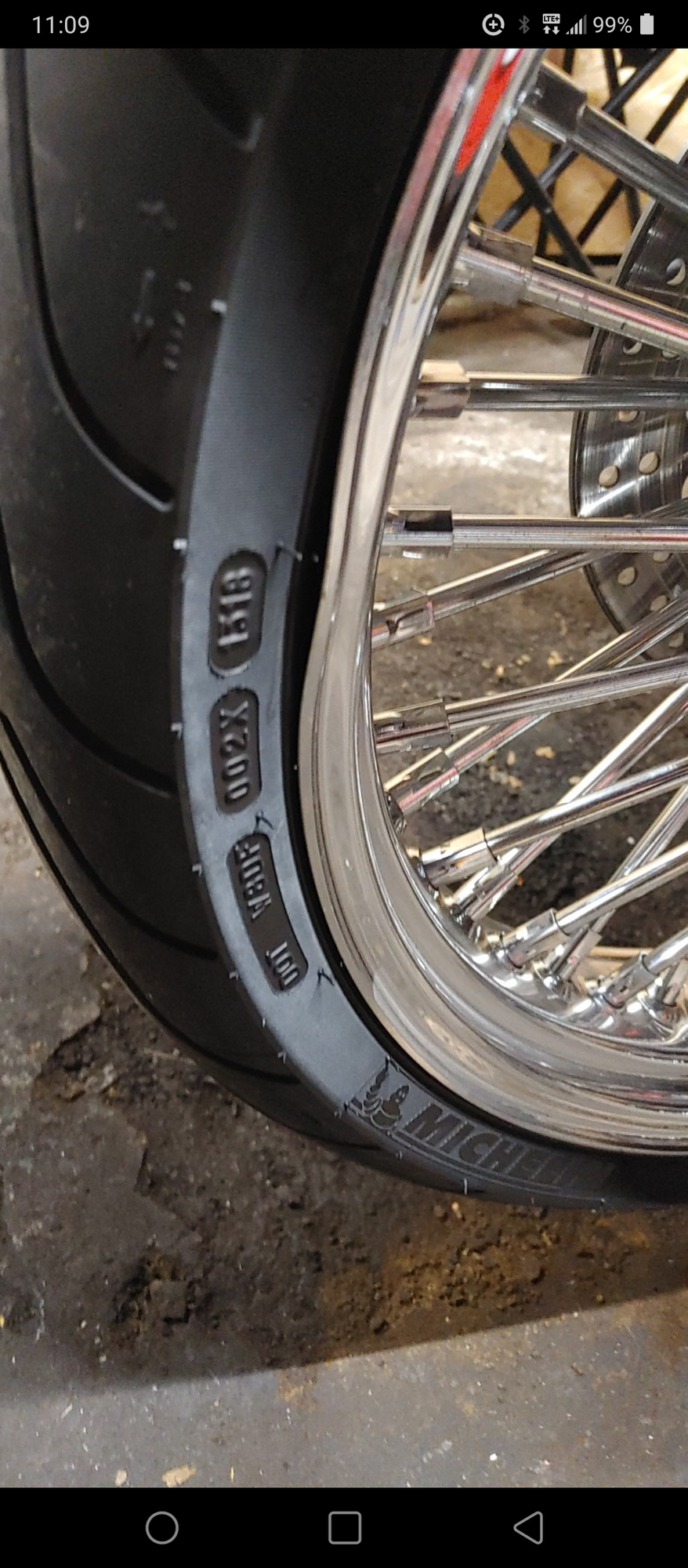

Pot hole damage...ugh.
is this salvageable?
Seal holds, no leaks , tire is good. Only on left side

i would have no problem with supporting the other side and placing a wood block on the bend and giving it whack

Surprise there was no damage to the tire.

i would have no problem with supporting the other side and placing a wood block on the bend and giving it whack[/QUOTE]
your not out much giving this a try.

I have one of those in my front star. Not as bad. I know it's very thin aluminum. I was thinking C clamps with a lot of support on other side.
Never done it however. Don't have the old original rim.

Is that steel or aluminum rim? Both can be fixed, but you don't want to smack aluminum, you must squeez slowly, or it will crack.

Try a rubber mallet, or, a piece of 2 x 4 with a mallet. Do some test hits, and see how it goes. Let us know what you did and how it looks after. I suspect it's leaking a bit of air slowly.

After a hit like that I’d also check the wheel, and head bearings.

I have had that happen before dam pot holes I would put about 45 lbs of air in the tire then give it a shot with wood and a lump hammer. If your air pressure was up around 38-40 psi that would help from not happening again.
This was mine
