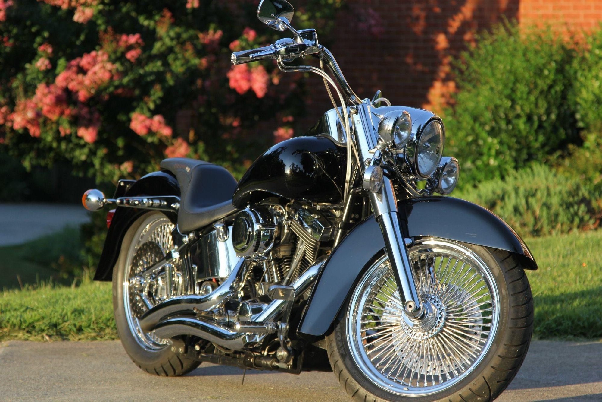

Default Radial lacing experience?
So a friend of mine has 100 spoke radial lacing for his wheels and has never had an issue with feeling like they were weak or doing any damage to them. But the manufacturer of these wheels say that they are weaker and considered to be for "show bikes"...I guess meaning you aren't supposed to ride on them??
Does anyone else have radial lacing that aren't the fat spokes that are so popular now? What is your experience?
Friend says he just doesn't brake hard or ride like a moron and he's fine..... thoughts?

With pattern, on both sides, of each spoke radially going to C/L of the axle from the rim, there is no counter force to keep the whole set of spokes from bending/stretching during braking with the front/rear/both brakes. At some point the spokes will break.
Whoever designed these was a moron. They are unsafe to use on a motorcycle (or bicycle, for that matter).

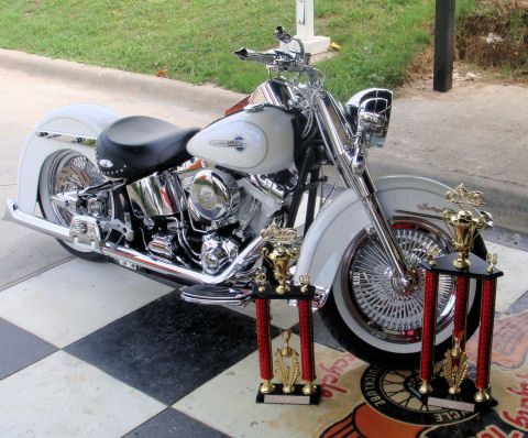

Here's another example

The problem occurs whenever coming to a stop. The brake forces applied to the center of the wheel and the weight of the bike, forward momentum, and friction of the road surface on the outer rim via the tire. There is a great twisting force being absorbed through the spokes. The spokes will stretch because the twisting wants to pull the rim toward the center. The spokes become looser over time.
They have tried to minimize this effect by increasing the number of spokes and their thickness.
It is physics and dynamics. That type of wheel is bad engineering.
Normal laced wheels have a "push - pull" setup with the spokes.
