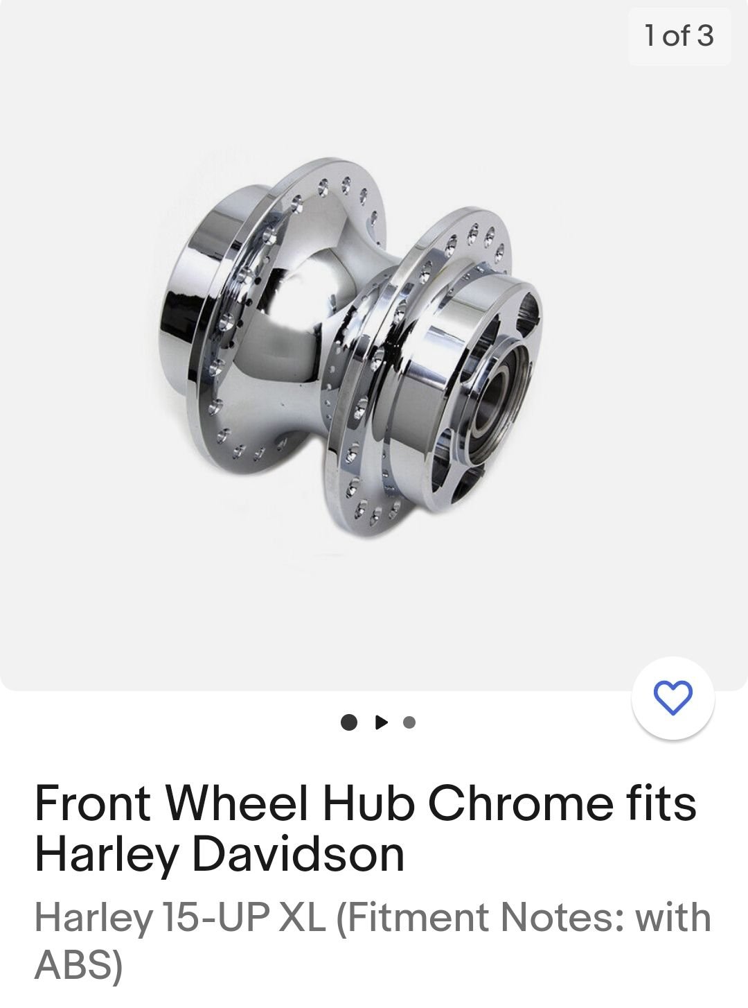

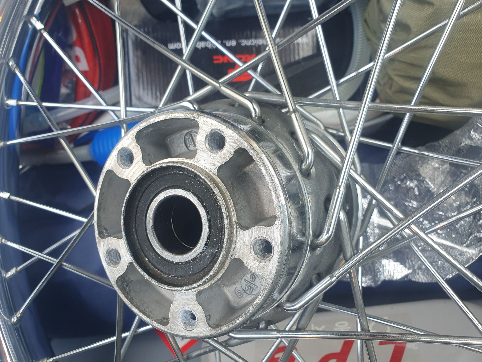

I have a Softtail 21" wheel, but I'm going to fit in to Sportster
This wheel does not fit due to the narrow fork spacing of the Sportster
So I'm thinking about switching to a wheel hub for Sportster
But the shape of the herbs is different
Will my wheels be compatible in this case?

If the proper spokes are available then you can do it. Good luck with your project.

Wheel in pic is the optional "Profile" tubeless spoke type
When disassembled it requires a special sealing rim strip , I suggest you verify if they are still available in Korea before proceeding.
You will also require different spokes to meet the flange angle on new hub.
And of course someone will have to lace and true the new assembly
I`ll suggest that it would be easier and cheaper to obtain the correct wheel
JMO
