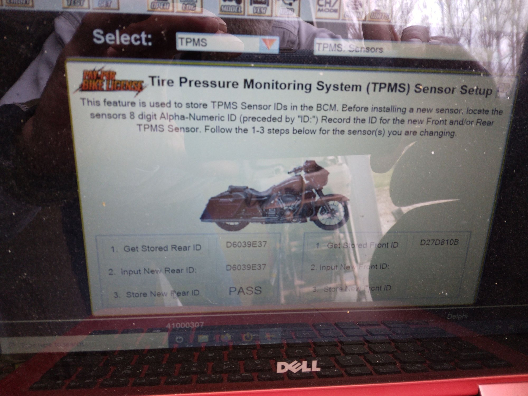

You will need to enter the serial number for the new sensor in the TPMS. Write the number down when it is installed.
You can do it with proper tool or dealer will do it and charge you.

I know when I added the sensors on the 2019 SGS, it specifically wants the identifier number for programming. My guess is, its not like a car that has receivers near the wheel for identification. Also people rotate the tires, and that would become a nightmare.
