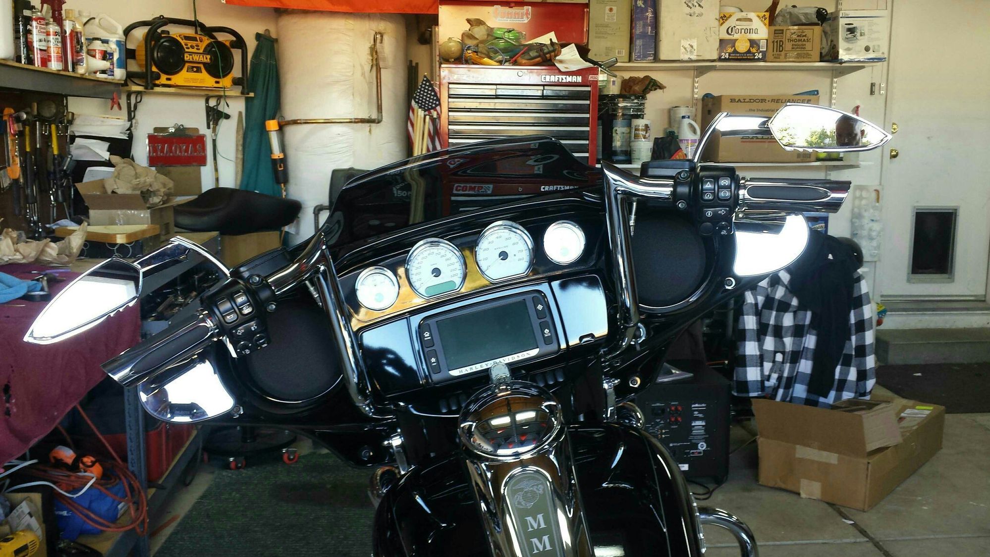

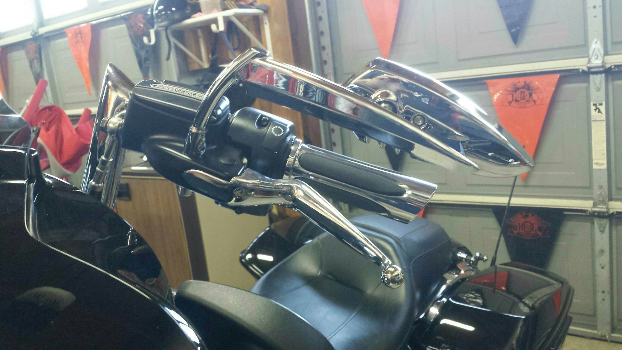

As everyone stated... no need for clutch or brake line, stock ones fit. The only extension you need the the NAMZ kit for hand controls. I went with 8" extensions because I wanted to over 4" extensions... a little extra is a good thing.
4 hour install for me included my 30 minute lunch.
The OEM TBW ( Throttle By Wire ) is good for up to 16" bars at least... there is a lot of extra. The only PITA is removing the pins from the Molex connector... and that's not even hard once you get the hang of it.
THEY WILL RENDER YOUR FAIRING MIRRORS USELESS if you pull them back anywhere past 1.5" from the fully forward position. I am 5'7" and have mine pulled back... that's how I know.... fully forward I can use the bottom half of them only. They came off...
I added some Arlen Ness Deep Cut gips, chrome levers and Scythe II mirrors...

After seeing this setup, and researching all types. this is the setup i am currently buying. Love the deep cut grips too.
