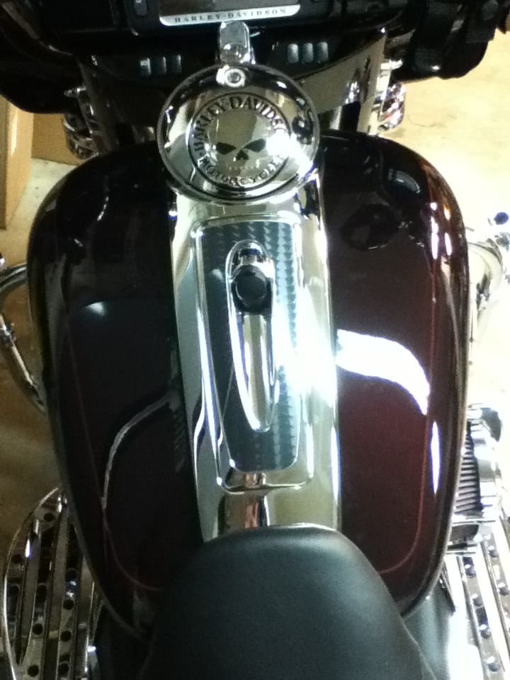

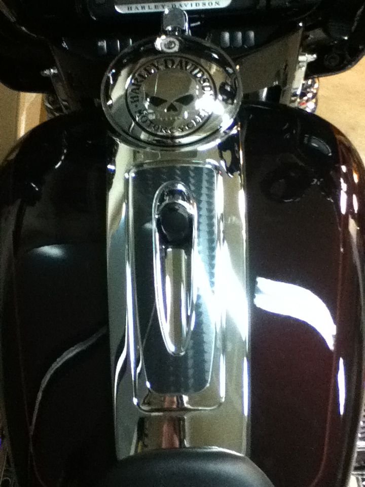

I am curious how you got the plug to stay in place in the console. Looking at the cable from Harley it does not appear to have any threads or other way to fasten? I really like this idea, but am curious. Thanks
If you open up the spring loaded cover on the end that you plug the cord into, you'll see a threaded ring that holds the cover on the plug. Remove that threaded ring and the spring loaded cover will come off. Install the plug from the back side of the hole you drilled in the console, replace the cover and then reinstall the threaded ring. Once you get one in your hands and look at it, it will be clear how it works. Piece of cake and WAY better than the stock mounting bracket that comes with the cable! I did mine when I had my tank off for a bar install:
