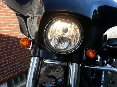

I had a two hour, unplanned ride, back thru the country where there are no lights at all. My stock light adjustment seemed ok a few times I checked it out on my driveway, however, coming back thru the country (where I live) was not fun.
I put daymaker, head, passing lights and did the CD for the turn signals. To say it was like night and day would be an understatement. Any lights must be adjusted, but now I've got excellent lighting in a demanding environment. Oh I also did the controls.
IMHO this is the best safety upgrade you can make, I'm not a night rider, but if/when it occurs, caution, common sense and the ride could be actually enjoyable.
I've actually taken the bike out at night 2 times for 50 mile rides, with the Day Makers and I am comfortable, where before I thought I if I get caught out again I might have to rent a room for the night.
Low Beam with Passing lights and CD signals

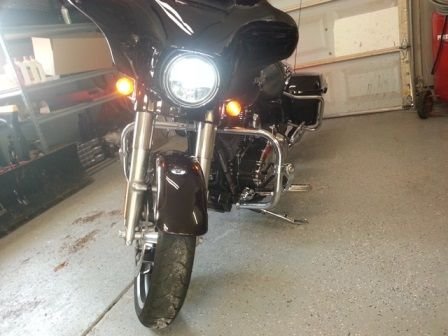

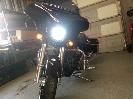

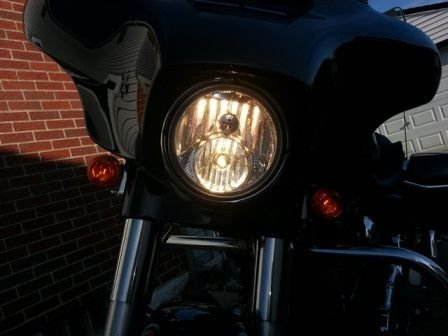

Stock low beam
Stock high beam
HD Daymaker led reflector low beam
HD Daymaker led reflector high beam
I know you did not ask about different lights, The dual halogen is a good light I just needed a little more.
And this made a huge difference in my night riding.
