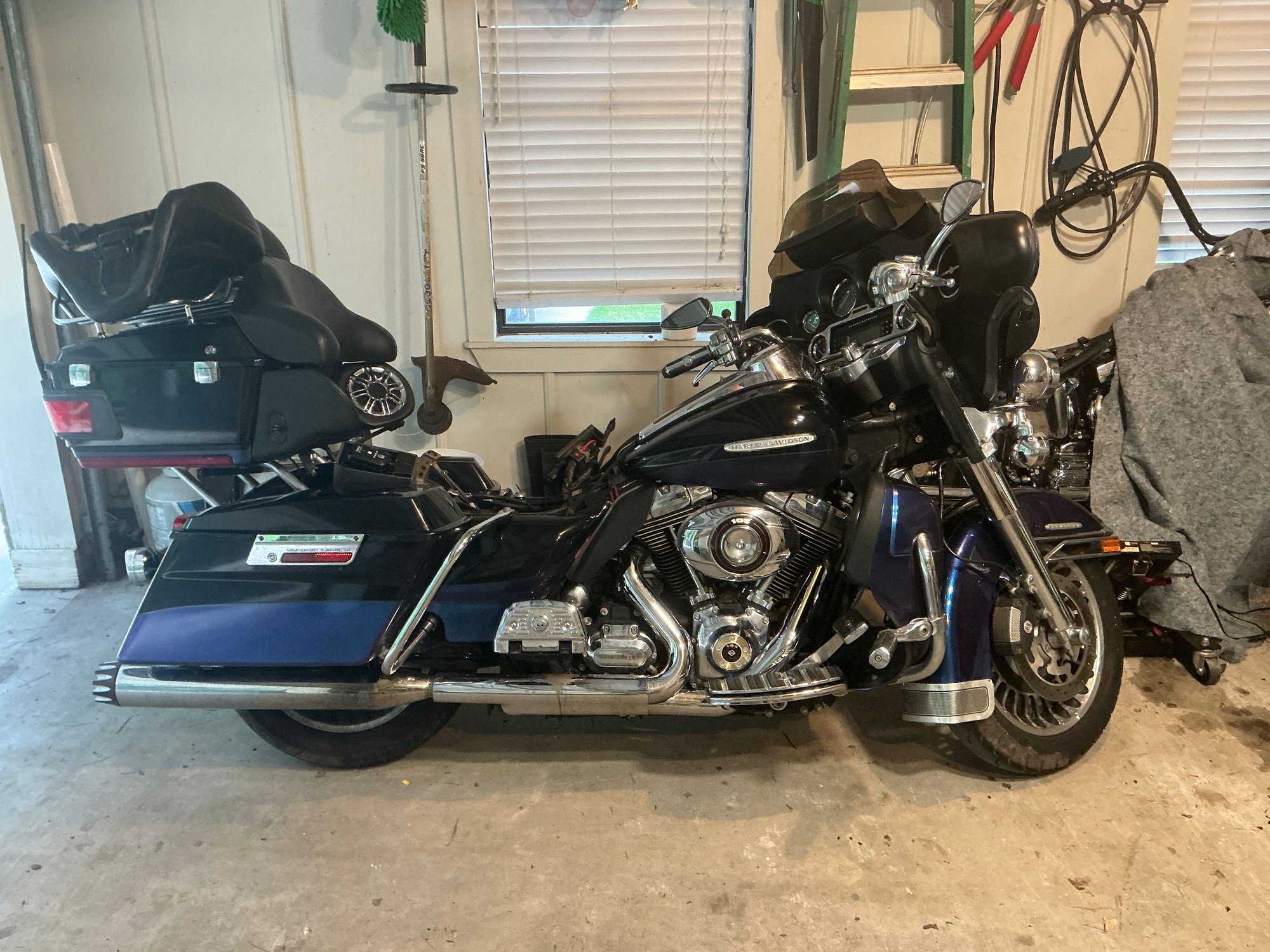

Howdy all!
Today I added a second bike to my garage in addition to my 1999 FXST I am finishing. I picked up a 2010 Ultra Limited. The guy that owned it had a heart attack a couple of years ago, so she has set up for a while. I got her home tonight. She ran great and will be getting a 3 hole change Friday when I am off work. The paint is in perfect shape. The chrome needs a lot of love, but nothing a polishing wheel and some polish won’t fix. She will be getting a K&N breather setup and new slip ons. The PO gutted the cats out of the headers, but the slip ons he put on there are obnoxiously loud and have a loud drumming noise while cruising that gives me a headache. I have the factory service manual already.

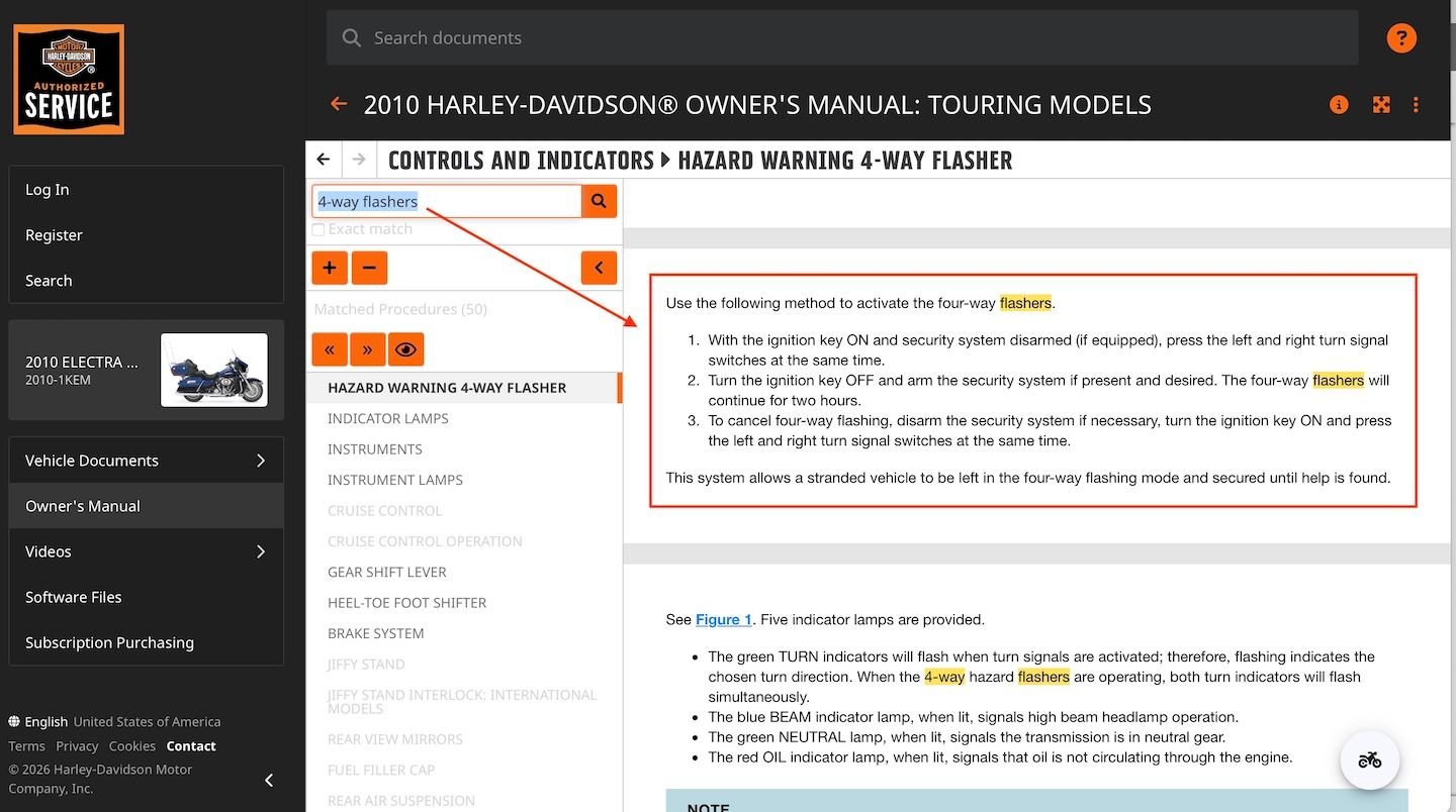

OP, go to the Harley Service Information Portal (SIP) and you can read the owner's manual, and get other info about your new bike. You can make an account as an Independent Operator, or read as a Customer
https://serviceinfo.harley-davidson.com/login
As far as activating the 4-way flashers:

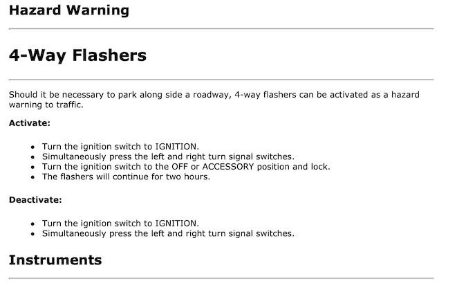

Those chrome switch caps are just caps, but they replace the black ones. You'll have to get the OEM black caps from your dealer, or cheaper elsewhere, like eBay.
I have a '13 King and the 4-way flashers work as below from my owner's manual...

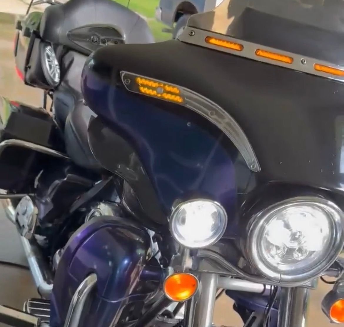

For the 4 ways, I am very well versed on how to turn them on. I owned a 2009 Ultra. The issue is they will not turn on. Signals work great, 4 ways do not come on. There are turn signals mounted on the front of the fairing and one of them is not blinking when the turn signal is pressed, so it may be related. I will need to look more into that.
I have the factory service manual in my possession and an owner's manual on the way.
Lights on fairing (hopefully someone can point out what they are)
