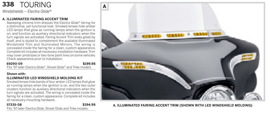

Originally Posted by cwhite6
Lights on fairing (hopefully someone can point out what they are)
Those fairing lights could be an issue on the 4-way. Here's the Harley 2011 catalog section...
Thank-you for that. I will pull these off and check the wiring for shorts or issues.

Messed with it some more. 4 way flashers work, they just take a little more finesse to turn on than I thought. Now, I am removing a crap load of shitty under lights that look like a 2 year old installed them.
