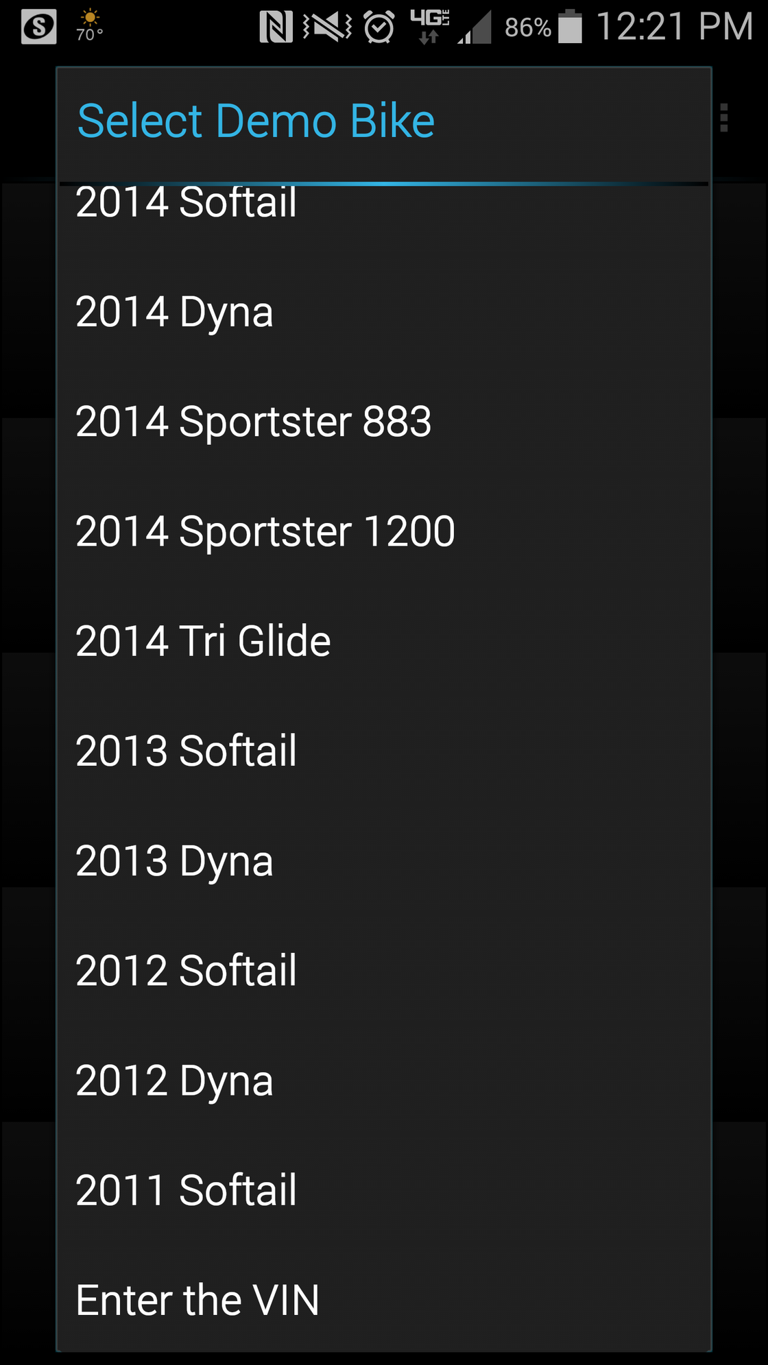

I bought the FP3 and downloaded their APP. Emailed Vance and Hines Support to see what I should setup with my Rinehart 4" and they recommended starting with Twin Slash Rounds with Standard baffle.
Then I noticed that they 'Standard Harley Label' reads '103 Twin Cool'. I have a 2015 Ultra CLASSIC (not twin cooled). Starting to think maybe I should take the FP3 back and go with a PV-2.
Anyone with thoughts ? (:::::slapping self ::::: THAT is a stoopid question )
@41inWV- Demo mode is not a 100% representation of the way the FP3 works with your bike. It is there for consumers to explore the application without having to buy the unit and explore the GUI.
In reality, the first time you plug the FP3 into the bike, it will decipher your VIN and only show you maps available per your VIN. If you wanted an accurate map lookup without being plugged into the bike, then scroll to the bottom of the Demo mode list and you can enter your specific VIN. Please see the screenshot below.
