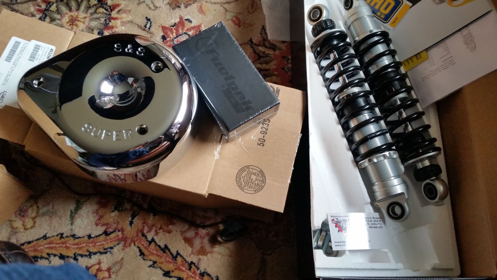

The 2.5s were about $800 to my door. That included shipping and a Paypal fee. You can avoid the fee by doing a deposit at a Bank of America. For me it was worth it to just pay the extra.
The 2-x are probably plenty good for most riders. I went the next step up because of the widely varied weighting on the bike.
Btw - they showed up today. Very exciting!

I'm looking forward to you initial impressions... Got 'em installed yet? I think I got his last pair. Another thing about the 2.5 is that they can be upgraded to the 6-x if desired at a later date.

For shame - everyone knows Bilstein is the strut of choice for BMWs.
I don't have them on yet. They showed up yesterday and it's been raining like a **** here as well as cold. It's supposed to warm up tomorrow and the sun may even make an appearance. I have some other things that arrived to add to the bike so it should be a fun weekend.

LOL... The Bilsteins are too harsh for my tastes and I got a helluva deal on the R&Ts. Those 2.5s sure look good. I can't wait to get mine and put them on the bike.
