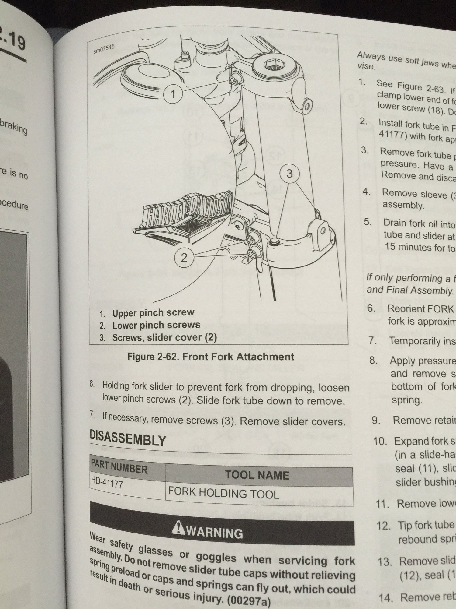

I'm using the official Harley Manual
Here is a pic of the cover and a couple of pics from the removal section. Only the small dash panel needs to be removed.
