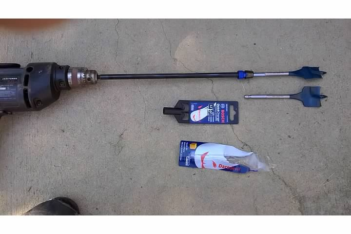

I decatted just over a week ago. Got rid of that crazy heat under the floorboard. Bike still runs awesome, no bad side effects, in fact it feels better but anytime you work on the bike you always think its does. (*L*)
I do have a XIED on order, should arrive today, Im on the fence if I want to richen the fuel mixture a little or not, bike runs so well but I hear, I may be able to get rid of that very low end "stumble" (for lack of better words) when taking off in first gear and maybe get rid of a little bit more heat. I guess by the weekend Ill make up my mind if I try the XIED. Only takes minutes to install but once I open them I cant return them.
One thing unmistakable is the better exhaust sound, now has that deep Harley roar. Not loud by any means but more substantial for. As one person said "now it sounds like a Harley"
Removed the mufflers and heat shields.

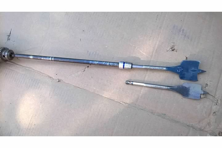

I didnt cut and weld, didnt remove the pipe from the bike either, didnt remove the O2 sensors. I just drilled, I also measured how far the drill would have to go to hit the 02 sensors and the drill chuck would have to be inside the pipe. However, I do recommend removing the sensors, I got lucky I could see how a piece of the CAT could break off and hit the sensor. Took about 2 hours start to finish.
Here is what I used... from Home Depot
1-1/4 and 1-1/2 Paddle Bits<br/>12 inch extension
Used the 1-1/4 as much as possible then the 1-1/2 to clean up and get as much remaining.
I measured about how far you would have to go to hit the 02 sensor. You do have plenty of leeway, I recommend removing them as you drill, even though I didnt.

Having opened one of these things up and knowing how difficult is was to remove ALL of the cat - there is NO WAY drilling can come close to removing all of the cat and I would be concerned about loose bits left behind.
