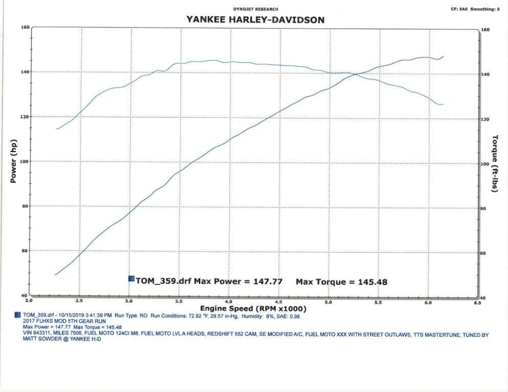

Old Oct 17, 2019 | 03:26 PM
Bigt001's Avatar
Bigt001
Joined: Mar 2012
Posts: 161
Likes: 92
From: Connecticut
Default 124”
