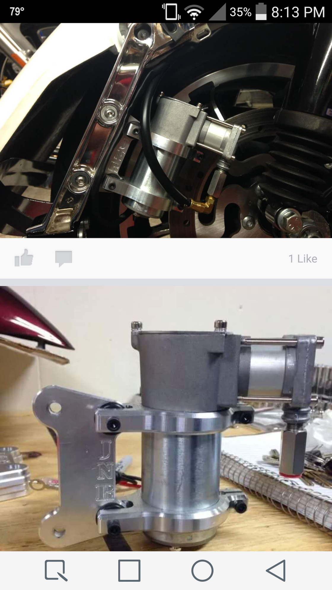

I'd like to put an air system on but I currently have ABS and don't want to part with it, as well as a JL 400\4 amp in the fairing. Since I have a CNC plasma table I was thinking about just cutting up a bracket to go under the fender (providing it all fits at full travel) to mount to the strut mounts behind the filler panel. I'm thinking 14 Ga and has a curve to cover the pump from road debris and keep water off it.
what do you guys think? I haven't looked under there yet, I know there's not much room though from taking off the reflector from the tail light bar.

Look at dirty air. They have a mount that goes behind the bag. There is also room under the fairing, it's where I put mine. The strut mount behind the bag is slick, did that on my buddies road king.

Two wheel terror makes a bracket for their pump

thats slick! I have an amp that takes up all the room in my fairing so the strut works perfect!
