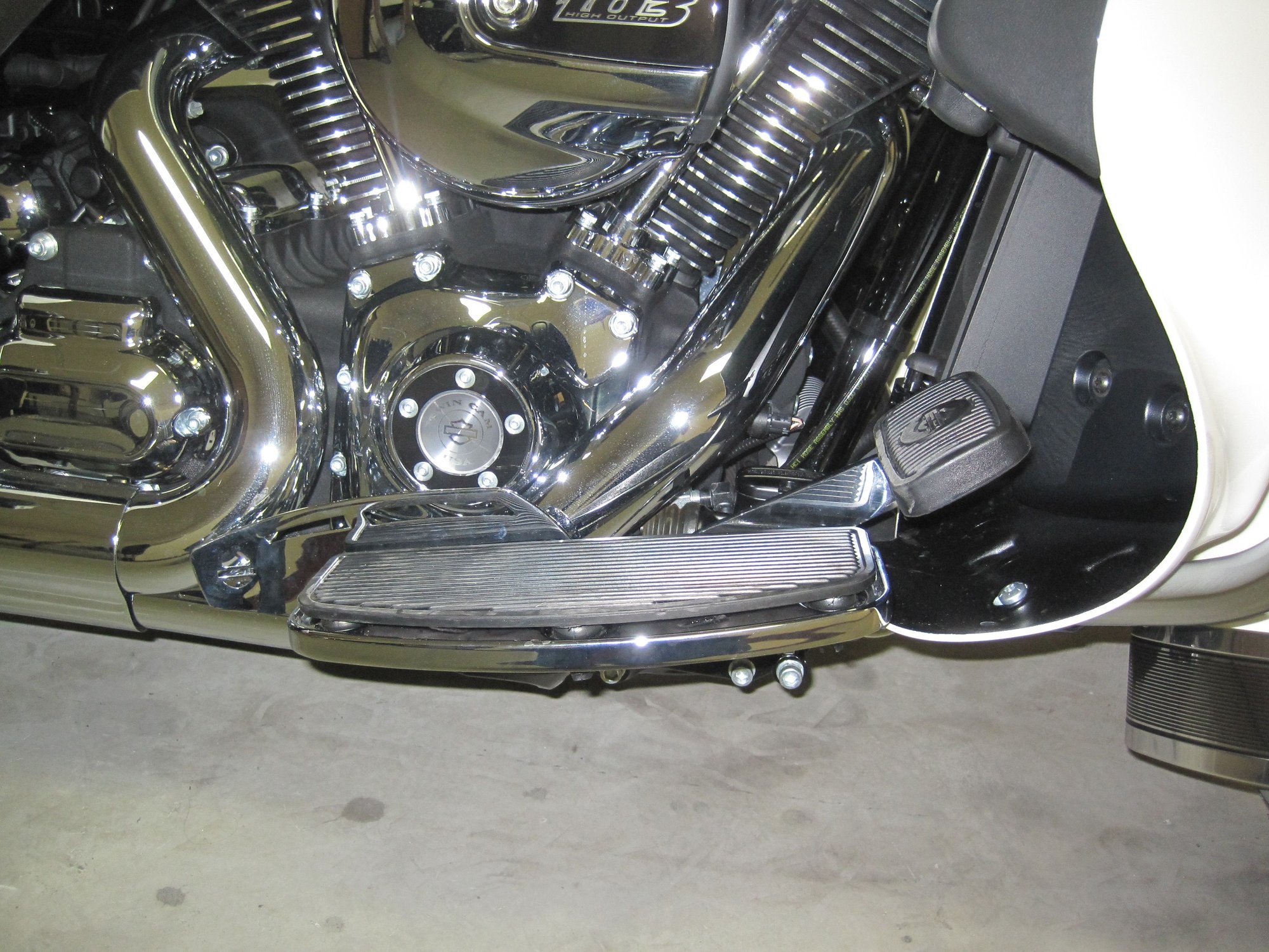

Originally Posted by GTK
Really like the linked system on my new SGS,but hate the position of the rear brake pedal,needs to be angled forward more.
I had to get the EZ Brake lowered pedal before I even rode the bike.
