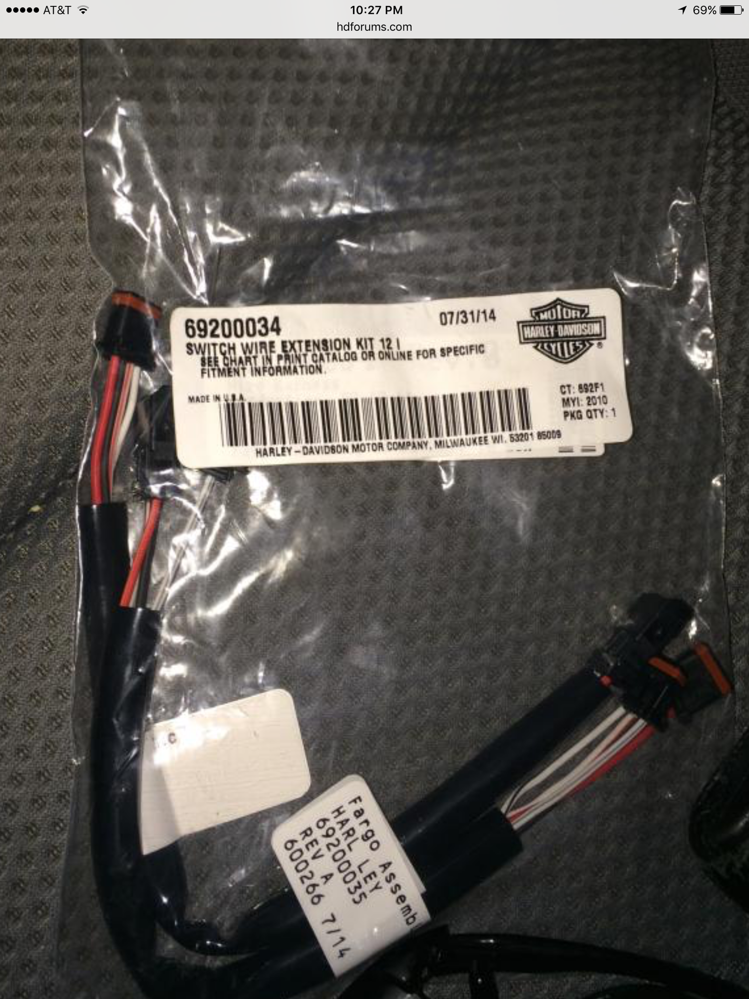

Sorry NAMZ, this is the wire extensions I used with Yaffe 8" bars they actually measure 9.5", the clutch and brake lines still had slack. The wires are ran international and this was the only extra anything I needed.

Just had the 2+2 narrow installed by a dealer. Existing cables were completely adequate. Only needed the wire extensions.
