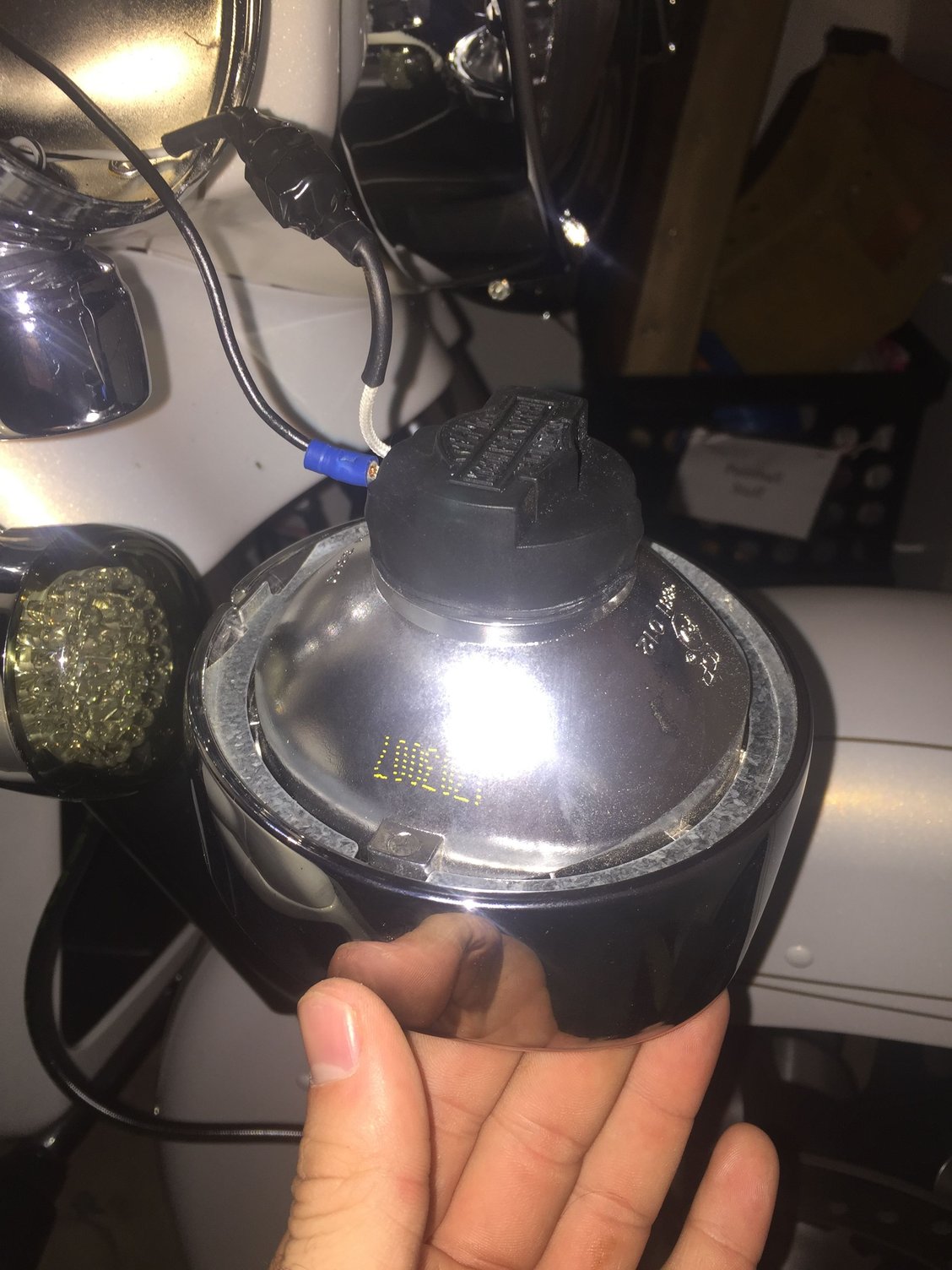

This is what the back of housing looks like, how do I replace this bulb? Anyone have one that looks like this?

I am currently trying to figure out how to replace on of these bulb, did you ever figure it out?
I had those on my Heritage Softail the black rubber piece with the Bar & Shield on it was stuck on with Sikaflex or Silicone I just put a small flat blade screwdriver under the lip where it connects to the glass part of the light and worked it around to release it, I did end up tearing one of the covers, I just put Silicone around the lip and on the tear when I reassembled it, the globe from memory was a H3
Hope this helps
