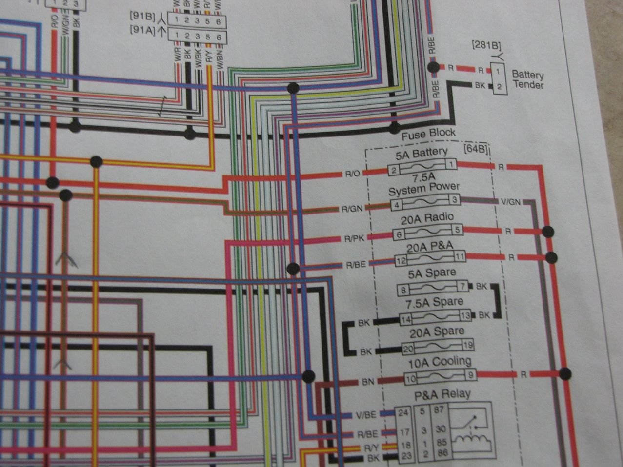

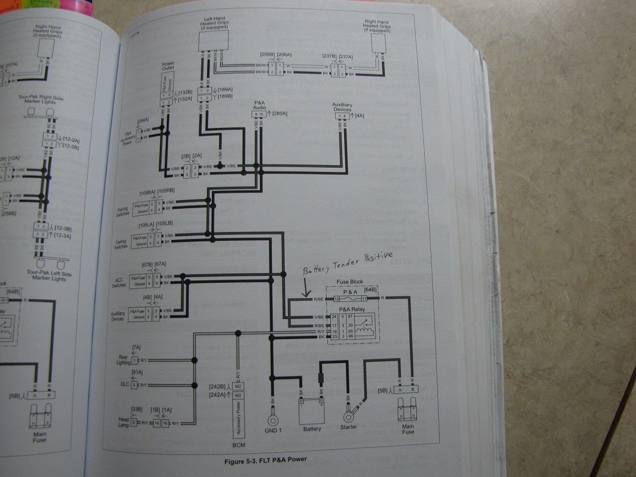

Safetyman is right if you take the the Battery clips and plug them into the connector on the bike they will be reverse polarity.
If jumping from a 2014 and up you would be trying to Jump the bike through the 50 amp Main and 20 amp P&A fuse.
If you are just trying to charge another bike with a weak battery and realized the polarity it may work as long as the draw is less than 20A.
