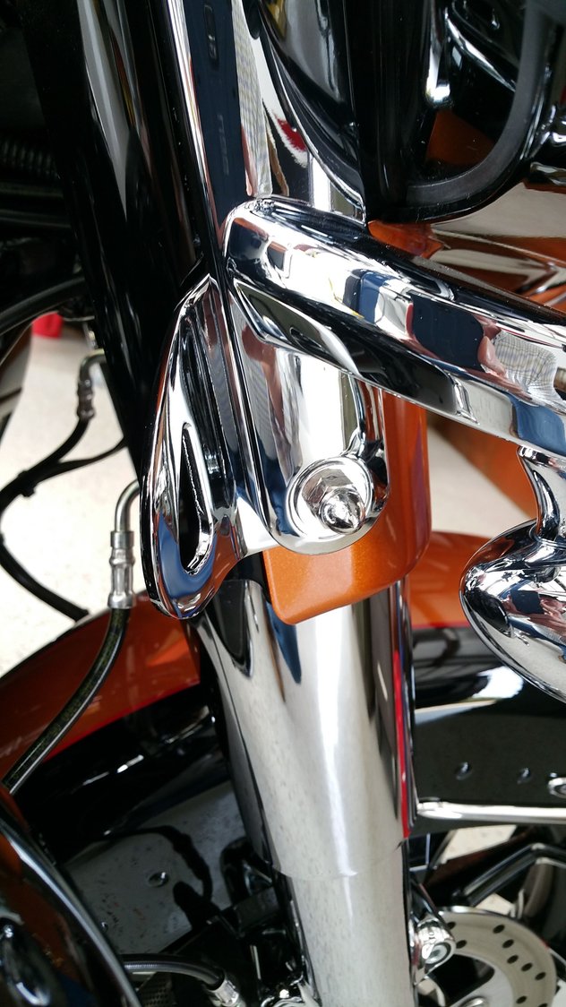

Originally Posted by Wharf Rat
These are the tie down brackets... Nice brackets but they come with cheap looking zinc plated screws. http://www.harley-davidson.com/store...-_-PAC+PDP+Top
I like these, THANKS!!

Picked up the recommended brackets mentioned earlier in the thread. $63 OTD and a breeze to install. Just use your original hardware and acorn nuts and toss the screws that come in the kit, they look like ****. THANKS to Wharf Rat...
