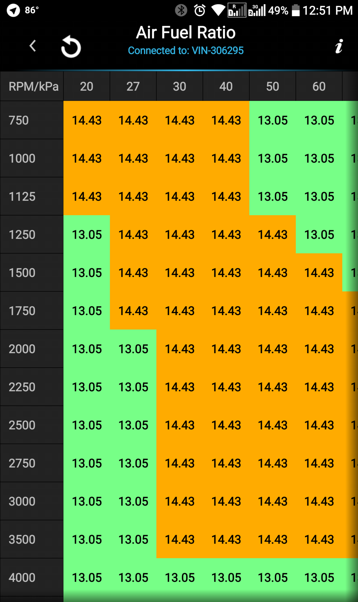

I have the FP3 and just installed the V&H 575 Cam and lifters. The V&H map was set to 14.35 AFR, but it was too rich. I raised it to 14.43, and it runs better (I auto tuned at 14,35, then 14.40, then 14.43). Do you have recomended settings for the cam?

How's it running with the 570 cams? What AFR ratio do you run? I'm running it at 14:43. I'm running V&H 575 cams and lifters, Cobra 2:1 pipes, and V&H VO2 naked intake.

If I knew how to post that screen shot I would. I will take a close look at it and let you know. The bike is a lot quicker with these cams.

Here are some numbers. 1500 RPMs At 20 it reads 13.05 @35 it reads 14.40 up to 50 where it reads 13.05 and @ 90 it reads 12.90
at 4000 RPMs it reads 13.05 @20, @35 and up it reads 13.90 to 80 and up it reads 12.80
