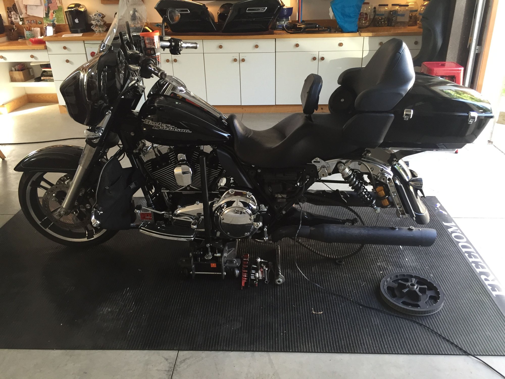

Thank you guys for the info and tips. Apparently with the type of exhaust and the shock length can change the way it needs to be done. I done it both ways, 2 times because the honda guy's decided to add ride-on tire blander and sealer. It caused server wobbling at high speeds, so took them back off and cleaned that stuff out and balanced with weights. It's better but still not perfect at speeds, after the new wears off we will see.
Any way my muffler were stuck, like you mentioned and I did use antisize this time. The mufflers took time. Second time only removed both shocks and lowering the J&S jack and putting a board under the tire allowed the axle nut to be removed easily and slide out the left side above the left bag support tube with no issues. Same way going back no issues using a 46mm and a 1-7/16 wrench for backup when adjusting the belt.

My exhaust is beyond the point of being able to be removed so I remove to two bottom shock bolts and let the jack down. This ally the axle to clear the slip on.
