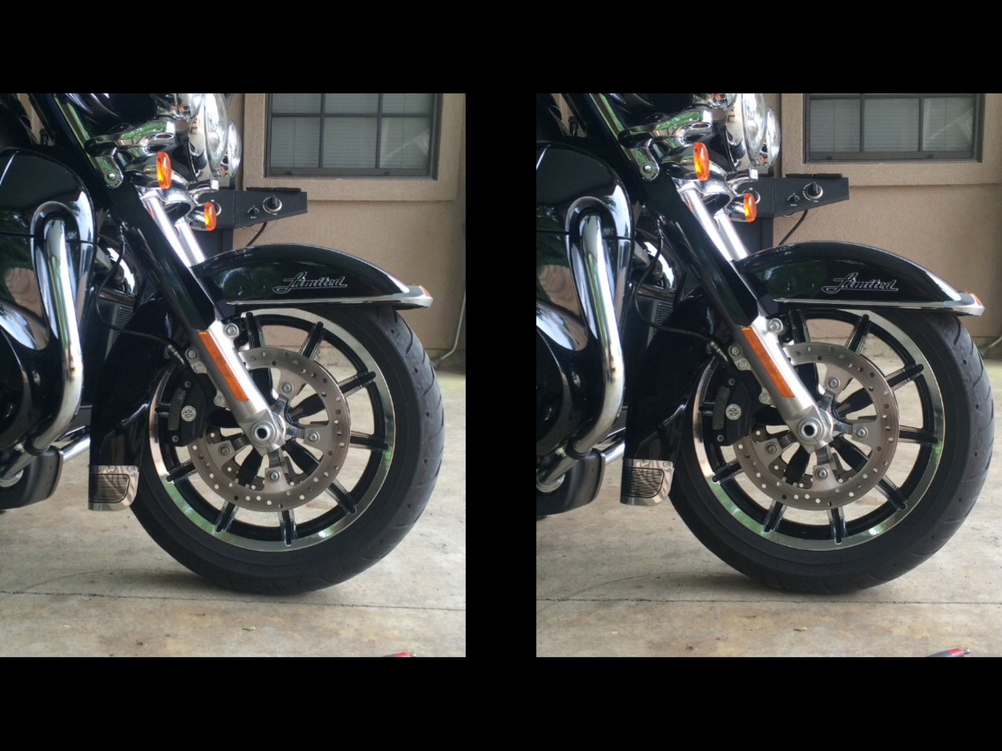

Originally Posted by Rocket67
Anyone ever notice that the front fender isn't dead center on their Rushmore? I saw that it was a little off and just pushed it back to center. It doesn't appear to have damaged any paint and there is no bends of stress marks showing. Granted, it was only a 1/2" or so off so wasn't moved too much. I guess it's ok, it's stayed in the same place but wondering if this is common. It appears to be pretty easy to bend, like someone could walk by and accidentally bump it and it would move a bit.
My fender never fit perfect and with it lowered an inch in the rear, my ocd couldn't handle it. This is what I done to get it as close to the way I thought it should fit and it can be tweaked side to side.
